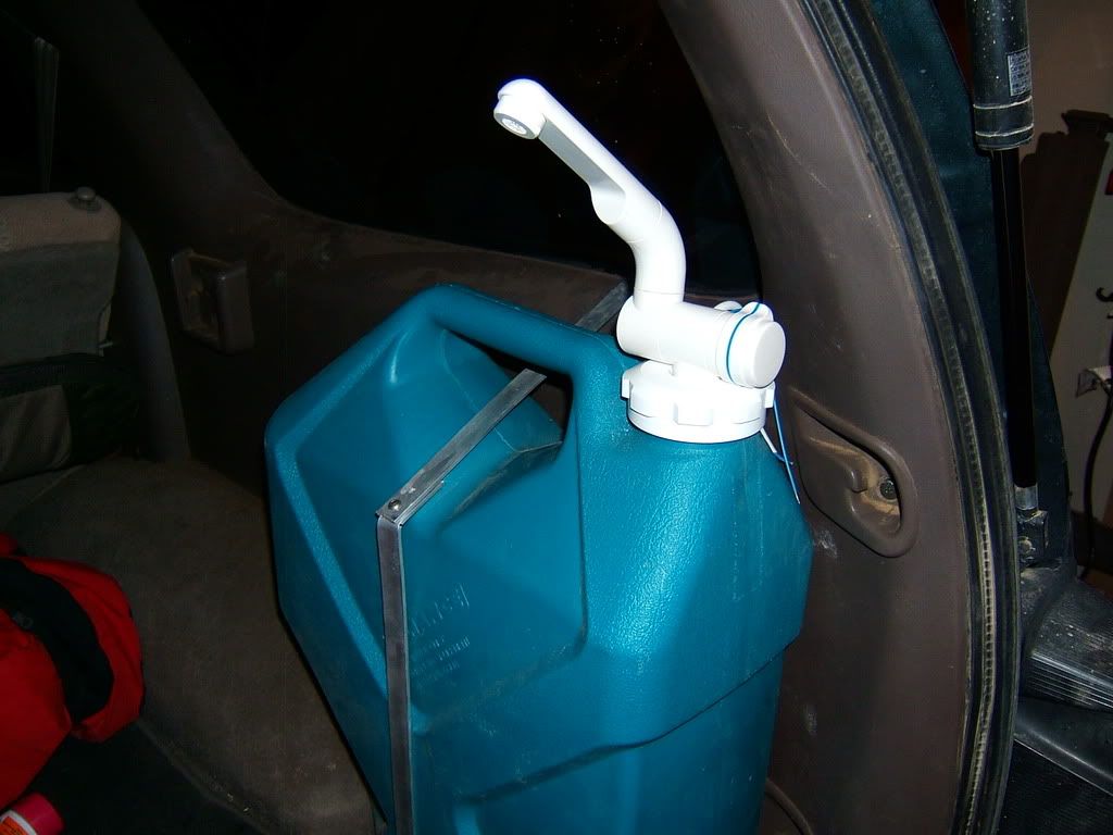

When I designed my water system for my 4Runner, I went with a submersible pump that sits in the bottom of my water jug. (similar to BajaTaco’s design)
You can see my build here. I think you could do something similar by mounting the faucet to the sink, and running the hose out the back to the jug.
