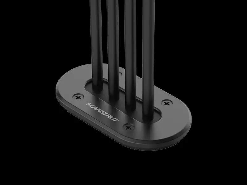

I didn't catch this thread earlier, but another option out there is Scanstrut. They're UV stable plastic originally intended for the marine industry. They make horizontal and vertical passthroughs. I've got a couple on the top of my truck that are a few years old. I did spray paint them to help protect them from direct UV light. They do have some aluminum cover options:
