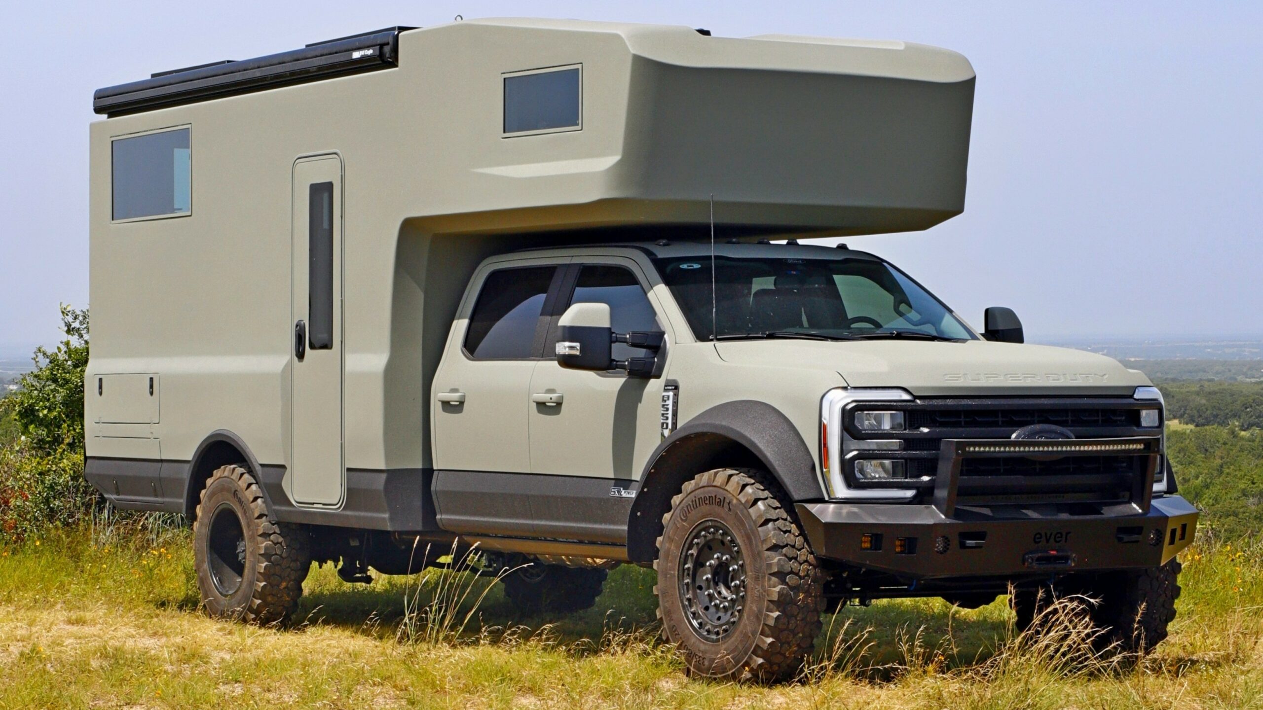

The shells come without any cutouts aside from the entry door and fixed skylight - those are generally handled by the person / company doing the finish out. The cargo doors aft of the rear axle are set but all other cutouts (aside from the entry door and fixed skylight) are handled by the company doing the inside finish out. Hope that helps!
Yes, this helps. What is on the forward left side of the box since I there doesn't seem to be any storage there. Would I be able to visit your facilities in Fort Worth?
Not trying to downplay your achievement. Offering shells of this caliber is awesome!
However, with all that hard work and premium features you then utilized the Alibaba China (Tern) non thermally efficient "euro" door? Those doors condensate like crazy.
What was the thought process there, looks like you used premium outbound type windows, why deviation on the entry door?

Hey SootyCamper, We'll test the doors more once we're conditioned inside but the shell of the door is a block of foam with an aluminum skin and a double paned (acrylic) lite. There's a few companies on Alibaba making very similar doors and I feel good about this one but if there's issues, we'll address it. We used an off the shelf component because there's only so many hours in the day... We're also posting updates on our IG and YouTube as we have them. Thanks for the feedback and kind words. They're greatly appreciated!
That's actually a super deep storage well; it's like close to 20" deep. I'm using it for my 42gal gray tank. For sure! Come visit us in FW; it's an easy flight into DFW. We hosted two groups last week; reach out if you want to setup a quick trip-
