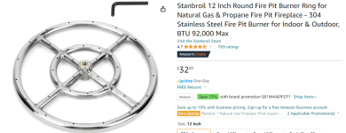

Well 6 years has taken its toll on my original DIY propane fire pit.
This time I took the easy way:
Which meant using a 90 fitting through a hole in the bottom instead.
The valve isn't necessary but I had it on hand so wanted to try it out.
View attachment IMG_0561.MOV
The new burner has twice as many holes so distributes the flame better than the old one.
Anza Borrego National Park requires all fires in a metal container so it can in hand over spring break where we used it almost every night.
