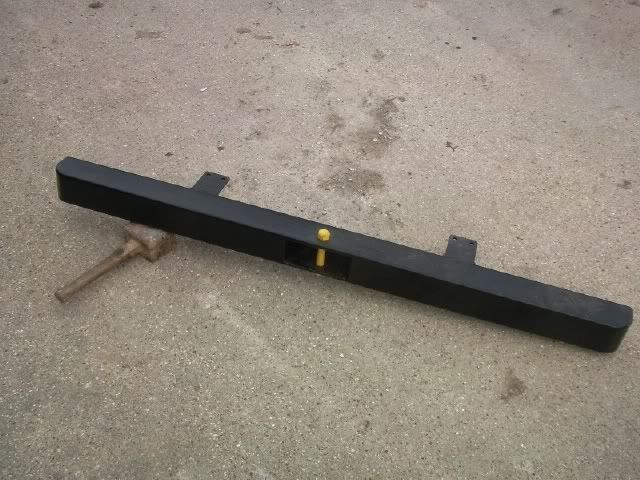

Can you tell me what they do with the trailer hitches in the UK? You know what I'm talking about with the C-channel bolted to the bumper, and then a tow ball bolted to that? Do they do anything to brace it in any way? Anything to prevent the thing from becoming a plow? What's the width of the channel they use? I've seen lots of pics of them in magazines, but not the details. Wondering if it's just as simple as it looks.
I think I like that idea better than the reciever tube in some ways. The ability to bolt up a DB tow jaw later, for example. And it looks like a more rigid way of getting a huge drop length without it rattling around.
I'm not sure - the only tow hitches I've had on my Discoverys have been pretty standard ones. I know the things you are talking about, though. I don't like the sound of them because it seems to me there's a lot of leverage twisting your bumper. A couple of struts going forward to the chassis rails would fix that problem.
Btw.. by the pocket and pin thing, do you mean something like this:
(for a Defender, in this case)
Yeah, I was thinking they'd twist the bumper too. But they're so common. <shrug>. I'll probably just end up doing the receiver tube thing, and struts to brace the huge drop tongue I'll need. Since I need to be able to mount up my motorcycle rack anyway. Of course, now I'll need a crane to get it up there!
Yeah, that's the pin and pocket thing, not sure the proper term. I've seen them on the front of G-wagens:
