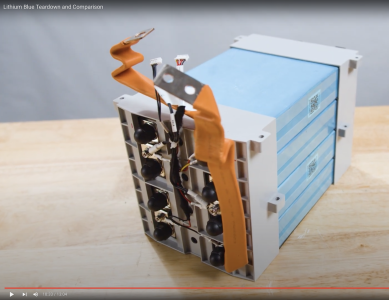

So Will Prose kicked a hornets nest with a teardown video of a failed 100AH BB by showing that it was, according to him, a design flaw with the mounting of the positive terminal leading to overheating, melting of the plastic frame through which the + bus bar was bolted to the + terminal using an aluminum bolt.
The + terminal was loose and wiggling, the bright red epoxy seal was heat discolored to brown, the votage and current were dropping out and there was internal arcing inside the case.
Battleborn has made this exponentially worse by responding very defesively that this is an intentional failsafe to prevent thermal runaway, which maybe is true as there appears to be no cases of runaway, but . . . .

They put brass and aluminum together which is like mixing oil and water in an engine. On top of that they didn't take any extra measures knowing that aluminum for at least 40 years has caused 1,000s of electrical fires due to poor connections.
The Lithionics review was instructive. There are Chinese made batteries of comparable quality WHEN the brand specs them properly.
Even the bolted (not welded) connections to the aluminum terminals are suspect. There's been such a concern over the resistance to balance the cells that the contact paste usually used on bolted aluminum terminals hasn't been used. Normally the cell are welded but studs were added (with varying degrees of failure) for DIY users.

Multiple batteries, many with no signs of damage (such as a slanted terminal, for whatever reason), all exhibiting the same problem? This isn't "user error." This is a bad design. Will added a pinned comment to the 2nd video where a user recorded the + terminal hitting 560F.
Additionally, BB's "design" of this "thermal disconnect" is not approved by anyone that matters. Using a sacrificial piece of plastic to "create a gap" when it gets too hot? Sorry, no. Maybe in 5th grade science class that might've been a good idea. There are cheap and very effective devices that are approved for such uses (fusible links, thermal breakers, etc), there's no reason that BB should have ever gone with such a ridiculous design. In reality, I suspect they're trying to come up with an excuse after the fact and what's happening with the plastic was never its intended purpose.
