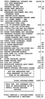

No driver assist package, no electronic dash. Just a very basic build.
Upgraded the seats, power windows and locks, basic cruise control, power mirrors, small factory 120 VAC inverter.
CDN $.
