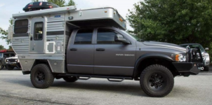

Let’s talk about overland flatbeds, flat beds, trays, camper trays, whatever you want to call them! Because steel adds a significant amount of weight, I am only going to be discussing aluminum options here...
When sourcing a flatbed for your expedition build, one of the most critical yet often overlooked factors is deck height - that is, how high the bed sits once mounted on your truck chassis.
Custom-built beds typically allow for a lower deck height, which not only improves stability by keeping the center of gravity (COG) closer to the ground but also reduces the overall height of the rig. This lessens the risk of running into low hanging branches on trails, or your rig being too top-heavy (which is not safe on super rugged terrain).
Many mass-produced flatbeds, while much more affordable, are designed for versatile fitment and to clear most wheels, and sometimes use thicker joists, resulting in a taller profile and higher COG. Just something to keep in mind when comparing pricing!

Many mass-produced flatbeds, while much more affordable, are designed for versatile fitment and mount above the wheels, resulting in a taller profile and higher COG. Just something to keep in mind when comparing pricing!
You don't have universal fitment, but since your camper is flatbed style you'll have to clear the tires as well. You surely know this, but thought I'd mention it...
Agreed - the deck height is dictated by the size of your tires and your suspension up-travel, plus the need to clear various suspension bits, etc. You also have to accommodate the height of the truck cab and either add spacers under the box or raise the deck height such that the cabover will clear. An off-the-shelf or custom flatbed will have the same deck height assuming they have the same clearances for running gear.
thank you both, I made some small edits to the post to hopefully clarify these points!
definitely an important detail to consider. my cab over height was originally calculated to eliminate unnecessary awkward space between it & the truck cab, while still mounting the deck as low as possible without voiding the option for larger tires if needed. with the hiccup in ordering my new flatbed, I suppose we will see how this pans out.
Will definitely address further in a future post about the shell / camper / truck dimensions!
