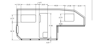

Here’s some quick dimensions of the camper shell:
As you can see, the shell is quite tall at 92” !
My goal was to keep the water and other heavy components as low and as far forward of the rear axle as possible to help with the COG. But I also wanted full flexibility with the layout inside. Thus, a false floor for the “basement” was decided.
Pictured is my 50 gallon fresh water tank, which will be accompanied by a 26G gray tank, both under 6” tall.
The raised floor is less than 8” total and is being structured around the components using aluminum extrusion. Once fully built, we will lay 29mm honeycomb panel over top and then layer it with a lightweight sheet of vinyl flooring.
The 92” tall camper, minus the 3” thick Cascadia walls/floor and roughly 8” basement - still gives me approx ~78” (6.5 ft) interior height when all said and done.
And, just a reminder. I’m 5’2” so even after all that, I may still need a step stool to access some of my upper cabinets! 😝
