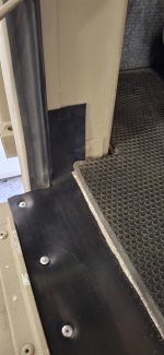

Once home, the first order of attack was to extend the hitch while also allowing for swappable attachment types, height, and retaining the hydraulic brakes.
I ended up duplicating the pattern of the original hitch slide mechanism. Functionally it's the same for the braking system, but now with the added adjustability I wanted.

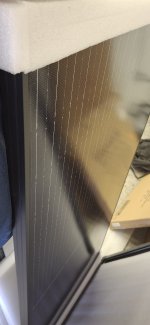

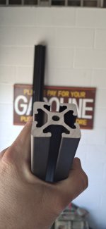

Well I haven't done much on the trailer since we have been using it non-stop, and I've not had much time. But, I'm currently about to make some changes to the trailer to get the awnings moved around, flipping the 270 to the opposite side, adding the ARB awning to the rear, and using the ARB room as an extension to the back for the boys friends, and eventually adding an additional 180 awning to the side the 270 is on now. This should give WAY more options, and then give me some 1515 8020 to mount the roof solar on. I have new panels coming in for it, and it should have 800 watts fairly soon.

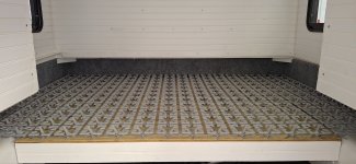

But I just got the Froli in for the mattress, allowing more airflow and comfort for them.

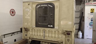

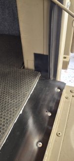

I also added additional tailgate sealing, this will DEFINITELY help a ton with reducing that last little bit of dust intrusion.

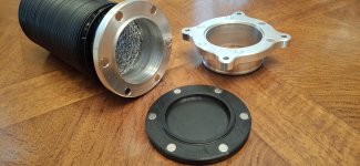

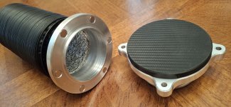

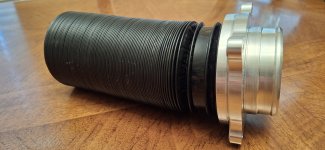

I also got in my billet aluminum pass through for the heater into the camper. I've decided to use a portable instead of a installed one, just allows more options, and quite frankly allows upgrading as technology changes, and it's literally a fifth of the cost. This pass through uses a carbon fiber sealed cover when not in use, and hose connecter that uses neodenium magnets. I'm currently figuring out where the pass through will be.
That pass through is a sweet setup. My heater did not like that ducting tho and kept causing it to set an overheat fault and shut down. After I changed it I had no issues, just something to be aware of. How does that awning hold up in the rain? I really want to get one of the OVS 180 awnings but was reading some people saying they didn't drain water/rain very well which would be a little irritating.
I'll keep an eye out for the overheating issue you describe.

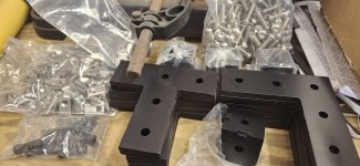

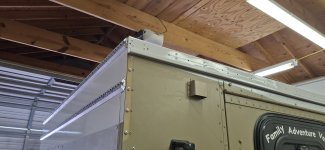

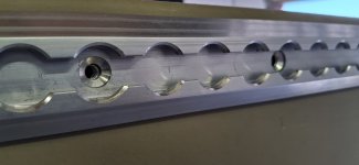

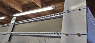

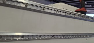

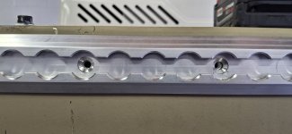

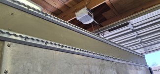

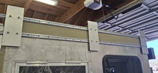

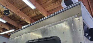

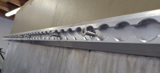

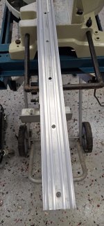

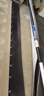

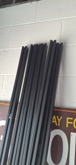

I've started the L track on the trailer. It will support the awnings now, as well as add support above for the coming 15 series 8020 that will be used for all the new solar and carrying racks. I spent basically all day drilling holes every 4 inches and then thread tapping each hole 1/4"-20. LOADS of tapping oil and time. Lol
Next I'll remove the mock up, and use permatex thread lock and sealing compound for the through bolts. Then start the other side and rear. Hopefully I have the awning moved over before our Thanksgiving trip.
20241119_111344.jpg20241119_113313.jpg20241119_120527.jpg20241119_120531.jpg20241119_121151.jpg20241119_122150.jpg20241119_122157.jpg20241119_122933.jpg20241119_150221.jpg20241119_150823.jpg

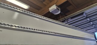

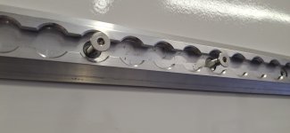

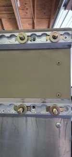

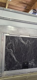

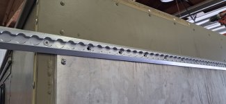

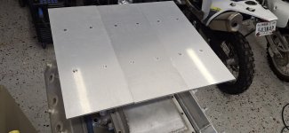

Pulled the mock up off, sanded everything, and painted. I let it dry for a day, and then cut down the rails to their final length. Once that was done, I used 3M adhesive sealant down the 4 channels on the rail, stuck it up on the wall, and permatex thread sealant/locker for the stainless bolts. It's definitely not coming off. I also drilled out the three plates for the opposite side as well.
This will be as far as I get till we leave this weekend for Thanksgiving hunting and camping, but I'm looking forward to getting the other side done, and FINALLY I can start paint.

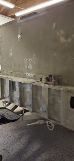

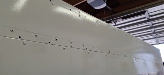

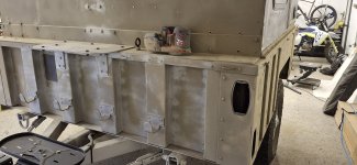

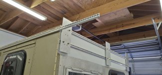

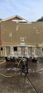

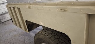

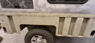

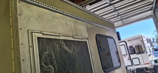

Well.... Things have moved slower than I would like, but life and kids have had a lot of goings on this year. I'm finally prepping for paint now. I've gotten all of the upper L Track mounted, and painted. Now it's just been days and days of sanding, filler, and more sanding. Once smooth I will do a strip wash, and then wax and grease remover before final paint.
20250415_170009.jpg20250419_143802.jpg20250423_111214.jpg20250423_111209.jpg20250423_111201.jpg20250423_111153.jpg20250423_111138.jpg20250421_130535.jpg

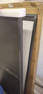

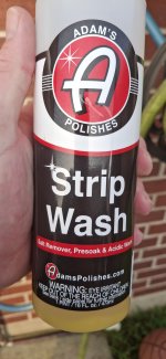

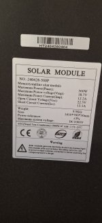

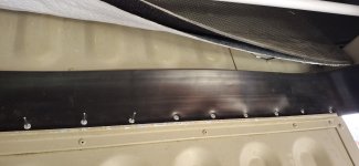

No, lol. Sanded all morning and filled the last pin holes with filler. Then once dry I sanded the last of it and strip washed. Now I'm waiting for it to completely dry so I can tape it up. Then wax and grease remover for a final time. In the meantime I've started sorting all the upper rack extrusion and brackets out for all the solar. Getting the solar mounted to a few brackets as well. I've also got my 180XT MAX awning unloaded. Should have 360° awning around it now once done, as well as 1k of solar panels. 3-300w and 1-100 to fit everything around the AC unit.
