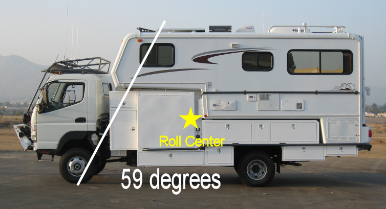

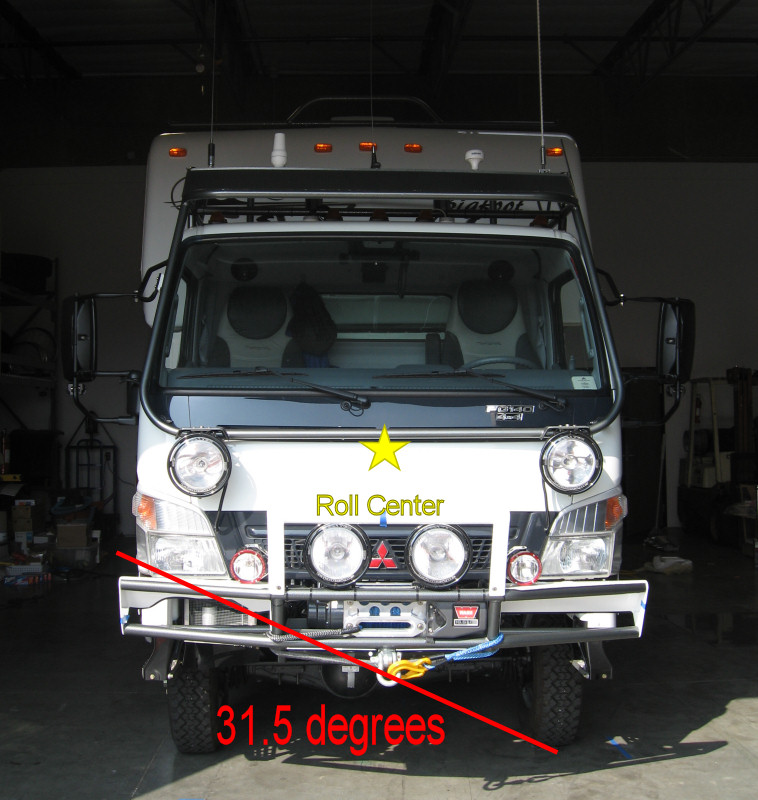

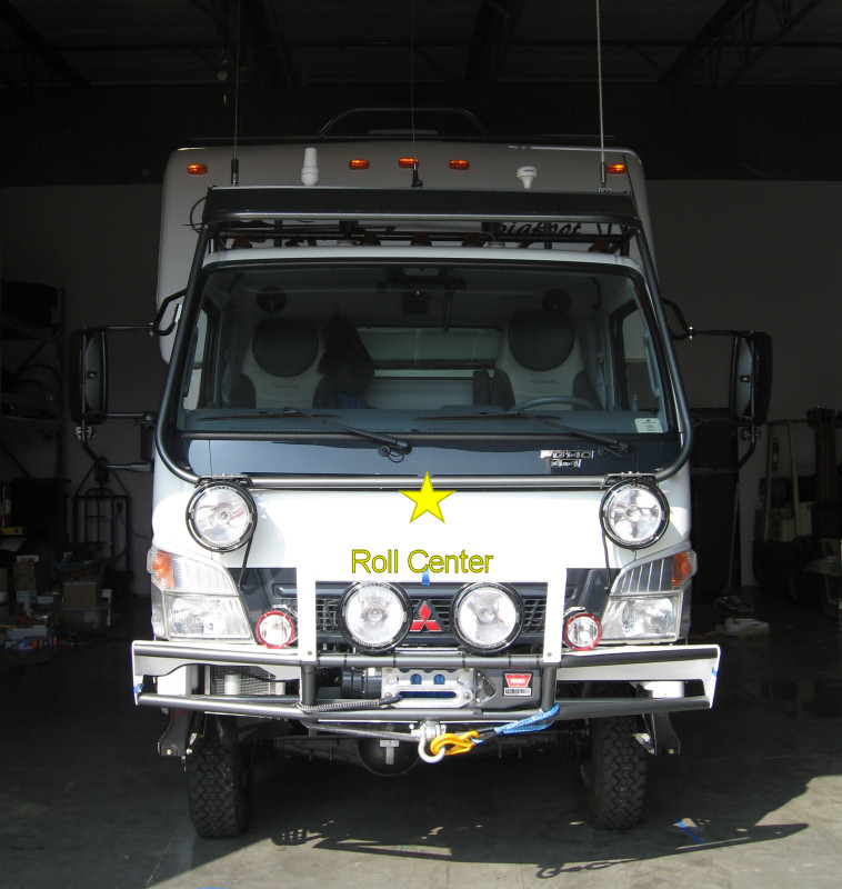

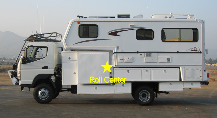

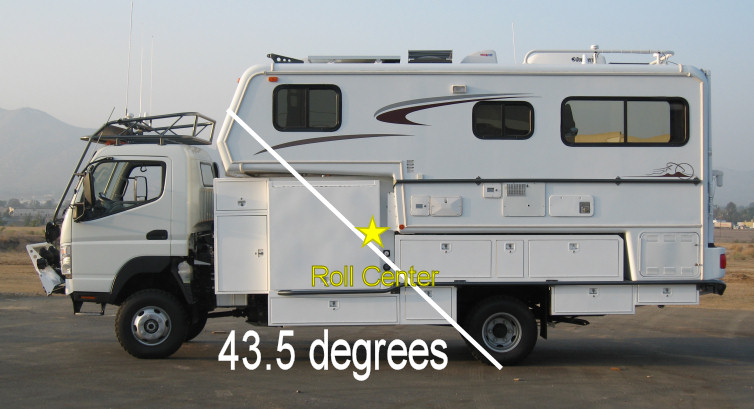

Revised roll center photo comps based on latest estimates of weight shift data.
These revised calcs are based on a very minor (relative to vehicle weight and weight of fluids) allowance for rearward shift of liquids and suspension travel during the tilt test.
CG is probably lower, but I'm going to stay conservative. R&L roll angles are based on front track. Values using the rear track are ~two degrees higher. Due to the 3 point pivot frame for the camper & rear storage boxes, I don't think there's any way to know the real roll angles until we get it on a tilt table.
CG: 58.92" / 149.66cm high, 98.14" / 249.28cm behind front axle centerline
Roll angle left: 31.12 degrees
Roll angle right: 31.56 degrees
Roll angle back: 43.48 degrees
