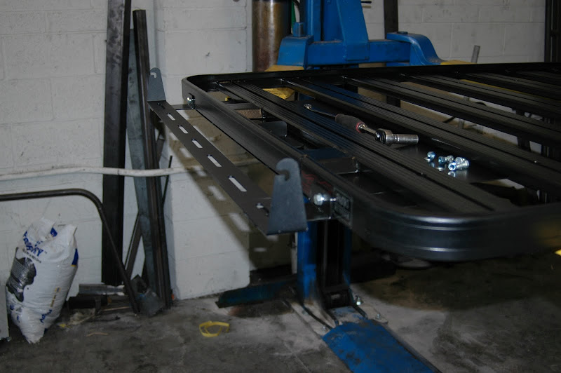

Starting with adding the accessories that mount underneath the rack, we started installing the air deflector, light tabs, and table mount.
Initial air deflector install:
The air deflector will need to be drilled to accommodate the light tabs. There will be 4 tabs, so the two in the center will require modification to the deflector.

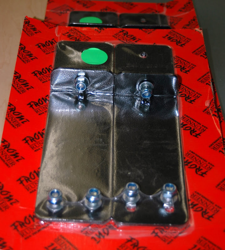

Here are the Light Tabs:
In the picture you can see the bottom two bolts on each tab are installed into the "T" slots, and the front portion of the tab needs to be drilled into the rack basket.
Here is two of the four installed, with the test fit of the Rigid Industries U cradle for the LED Light Bar:
Drilling the Basket for the center two light tabs:
At this point we flipped the rack over to work on the bottom side to install the Table Mount and start affixing the center two light tabs.
Here is the table and the mounts:
The Front Runner table mounts again mount into the "T" slots, and requires one hole to be drilled in the basket for the stay.
