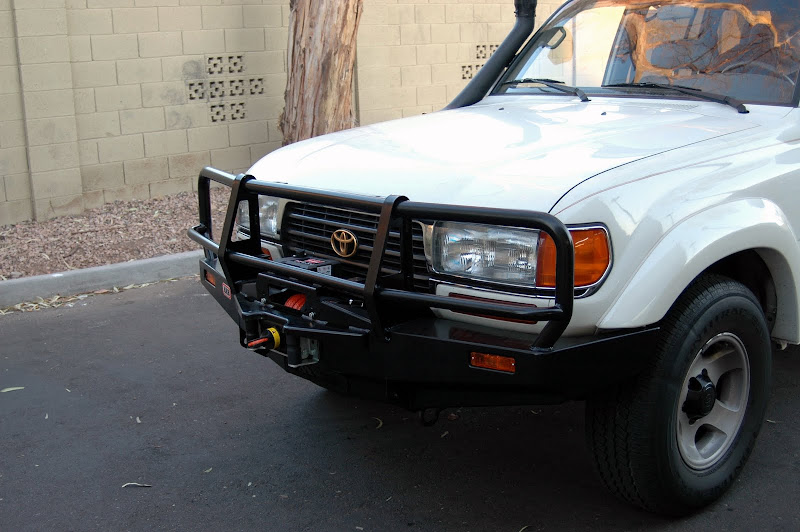

ARB Front Bumper w/ Warn VR12000
Well the ARB bumper is on.. The 80 Series ARB bumper is about one of the easiest bumpers to install IMO.

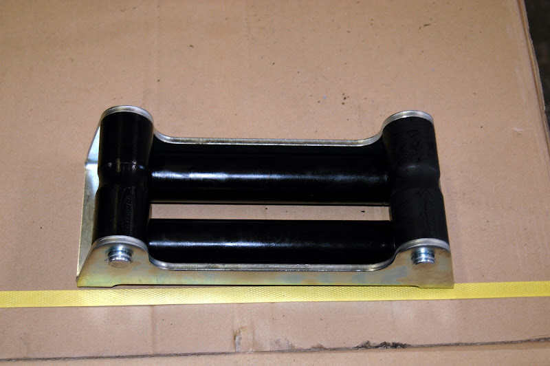

The hardest part is re drilling the roller fairlead, which was easy. In my case I swappped the rollers to the Daystar Rollers, which was as easy as removing the C-Clips and swapping in the new ones. The ARB bumper requires re-drilling the mounting holes 1" lower.
Daystar rollers installed:

I applied an application of rust prevention black paint, and installed the ARB, The Warn VR12000 required clocking and spacer kit, but beyond that it was a simple install with removal of the wire cable in place of Viking Trail line. I opted for 100" of orange 3/8" trail line w/ safety thimble and install was pretty straight forward. Over all the results look great...
Here is the black safety thimble, with the Viking isolator:
The control box was mounted via the Warn bracket included in the VR12000 as shown below:
Overall it is a perfect fit for the 80:
