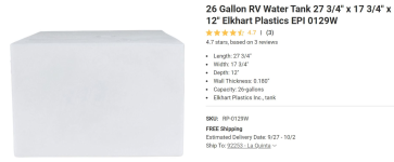

Auxiliary fresh water water tank planned.
My water tanks are inside the habitat for a four season design.
The rear bumper mounting leaves a sizeable available opening, about truck frame width by 20 inches deep. due to space under the rear storage box.
I will hang a spare freshwater tank there, truck frame width, by 12 inches long, 18 inches deep.
Time to engineer a spring mounting bracket design.

I'm not sure why you'd put the tanks on the inside, that is valuable space. Mine has 2 tanks, 35 gallons on each side and they're linked. They're insulated, and have heating pads to keep them from freezing. The other benefit to this is having a good balance, and the water keeps the center of gravity low. Having a ton of water sloshing around above the frame doesn't seem great. I put a valve between the tanks too, so in the summer, I can park where one side gets full sun and the other is in the shade. If I want a cold shower, I can just flip the valve to pull from the shade side. Want it hot, reverse it.
Some folks like winter, and want to enjoy Alaska in the winter. Those heating pads won't keep up with 24hrs of -20 degrees. I agree though, that having the tanks inside is pretty significant design commitment.
I considered doing tanks in the back seat since it's empty but I'll never be in -20 on purpose
