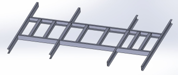

Habitat is in transport down hwy 10 to my welders shop
All metal for the subframe and brackets are cut (not welded)
Next steps: subframe mounted to the bottom of the habitat.

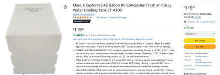

Mount the tank off your subframe... problem solved!
Thanks for the tip, we just might do that
(hang it off of the rear of the subframe under the rear storage box - fits in-between frame rails)
This would increase my freshwater capacity to 81 gallons.
