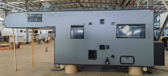

My habitat was not self built and was a custom order. (water tanks under the dinette seats)

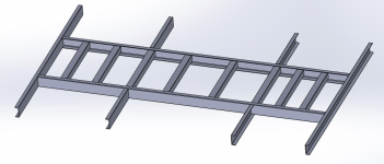

My habitat mounts 6.5 inches higher than yours on a subframe. (4 inch roof clearance)

I've spoke about subframe mounting to composite habitats before. No one cares too much.
I've addressed this in another post.
The issue here is not the subframe, even though the owner suggested that it was.
The tyres and suspension are more likely the cause of the swaying.
