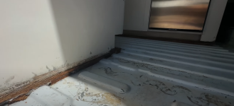

Seeing a lot of Van builds with "dry rot" in the wood floors. (from other company builds) Due to hidden "very slow" water leaks.
Once that accident happens, the whole interior must be removed or demoed.
On one YouTube video a owner of a Earthroamer said he has water damage in the wood floor near his entry step on his Earthroamer.
So on my mind when I decided to spec out the habitat; How do I avoid a dry rot floor.
My solution was to build a airspace of 1 1/2" below the wood floor.
If water dropped it would accumulate in this airspace. And not sit on wood surfaces for any length of time.
My floor in the habitat is elevated 1 1/2" off the composite floor by a inner subframe. This supports all necessary requirements.
