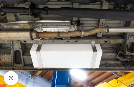

Calculating weight and front - rear distribution, it seems I can't install a aux freshwater tank at the rear. Water is heavy.
Now I think along frame mounted saddleback tank(s) close to the cab or underneath it.

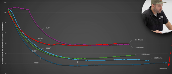

Dometic RTX 2000 12v A/C
Far superior to the rest
Start temp 100 F, maintained temp 75 F
With a 200 amp hr battery - 287 minutes
Avg draw 41 amps - much less after reaching the 75 F level.

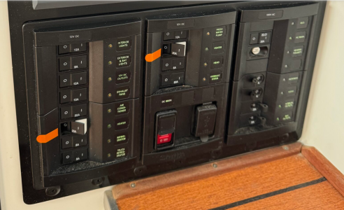

My main switch panel has many switches for electrical items and in addition lights. Several independently switched. I would like to slice in a 2nd bathroom switch for nighttime visits. I really don't want to alter the main panel.
I suppose there is a way to intersect the rear wire and add a dimmer.
What is the suggestion?
I study a competitors panel shown below and try to analyze if I'm missing something.
Yes you are.
You are missing the point that your build is likely different from other people's and therefore the electrical layout will also be different.
The main difference that I see with "your competitor" is that they are likely using higher quality equipment than you are.
Personally, I skimp on many things in my build, in an attempt to reduce the overall costs, but one thing I don't skimp on is anything electrical related.
Cheap quality electrical equipment is more likely to fail, and if that failure results in a fire (which is definitely possible in high power scenarios), then that can be life threatening in an RV.
Keeping costs down is a valid pursuit, but doing so in a way that could potentially endanger your life is not something I am willing to do.
Sometimes name brand, higher quantity equipment is justified. Well... it is in my mind.
Yes you are.
I see no evidence of quality differences, in switches, fuses, wire quality nor major electrical equipment. You guess wrong from 7500 miles away.
Layout differences is obvious. What I do see, is 12v wiring looms and 110 vac wiring looms are segregated. There is no shared fuse panel as I see in blue sea products.
My 110 vac fuse, main cutoff switch, all inputs and outputs as as well as shore power is all centric to a - management component - as part of a combo sine wave converter. With its own management panel mounted external to the sine wave converter. But the two were engineered as part of one product.
Missing something? So far not discovered.
