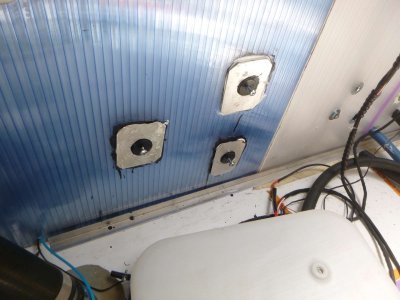

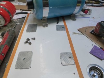

And after construction, simply glue a steel or aluminium or fibreglass plate to the skin to spread the load.
Material, size and attachment varied according to the load.

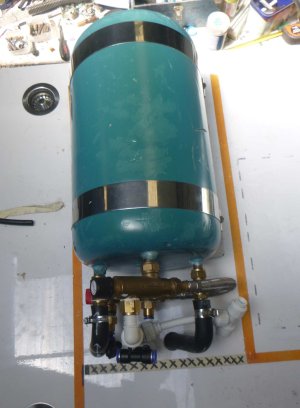

Our current vehicle has a 30L calorifier for the hydronic diesel heater. The new build will have a 10L calorifier for the hydronic diesel heater.
The change is to save weight. It is viable because of the reheat rate output of a diesel heater and it also has a 1000W immersion heater that can be run concurrently with the diesel.
It will keep up with an unlimited number of showers.
