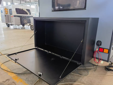

Large rear storage box, not connected by xps panel alone, rather supported to habitat with under box support frame, welded to habitat frame.
Mistake or correct? I ask myself. I designed the rear storage box to hold what I wanted to carry with me. The rear bumper is 5 inches below the opening door. The swing away rear tire frame must be opened to get access to the rear storage box. So no quick access, only when reached final destination.
My habitat does not have enough storage as it is four seasons with all equipment inside and side access doors for equipment servicing.
Items like, camping table, four camping chairs, outdoor carpet, large portable solar panels are not small.
I will build a 60 inch wide sliding bottom shelf for better access to the inside of the rear storage box. I found double expendable heavy slides.

Not sure this is correct
Personally, I don't see how this would be advantageous, given the shallow depth of your storage box.
Adding a sliding shelf will actually result in a small loss of usable space.
Then the habitat box should have been longer by the length of the storage box.
That would have given you more space and probably cheaper than the "tack-on".
That box is not legal in this country because it covers the tail lights from some angles.
Cheers,
Peter
OKA196 motorhome
Yes correct, but 3700mm on frame length was a standard size.
The product was designed for the Australian truck. (the wheelbase is different)
Tail lights are on the bumper (so there are duplicates) And I ordered a third brake light high up on the center back panel.
