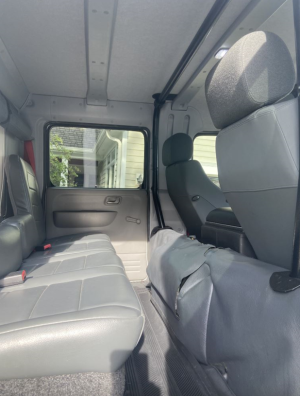

The crew cab has a tube bolted inside the cab from left to right behind the front seats. It is good for commercial use, but not for recreational use.
I did find the picture below. Unsure what the truck is 100%. I guess this tube was removed and custom roll bar inserted. You can see this from the picture.

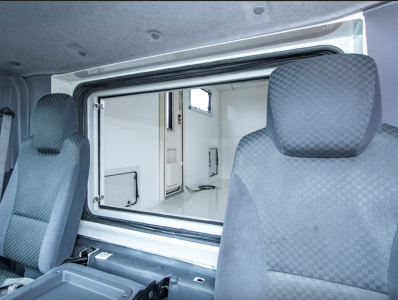

When using 12 gauge steel angle, say 4 inch by 1.5 inch. Then creating a picture frame design. Taking the frame and the truck to a body shop and requesting this replaces the rear window width by welding in place, 35 inches in height.
Now I look at a big opening with a "flange" from the 12 gauge angle.
I could cut a rectangle xps panel and use Sikaflex to install it on the flange.
Now I have a nice flat surface to cut the hole that matches my pass-through door currently installed in the habitat.

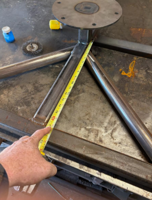

As I stated before we bought a steel rear bus bumper, 84 x 9. Welded two 1/4 tube 2x3 the inside length. We welded a swing away rear spare tire mount. That fits the 84 length, with two hinge pivot points to handle the weight. Then welded a tire tower for a winch mount. Now welded the tire wheel plate for the Isuzu bolt pattern.

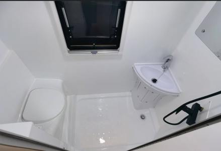

I wonder if this bathroom is too big?
Not too big, but park on a bit of a slope and the water will pool at one side and then you need to get down on your hands and knees to clean up.

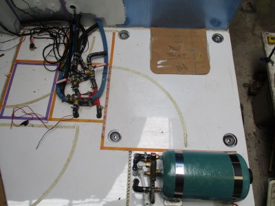

I solved that with my new build....
No "false" bathroom floor. 4 drains with shut-offs and filters for hair. Will handle any slope. The grey water tank is immediately under the bathroom and kitchen sink. OGO composting toilet, HWS calorifier within 500mm of the shower and the kitchen sink.
ps... the bathroom will get a sliding window so it can be left slightly open while driving. Then the heater can run from the engine waste heat and the bathroom (with its own heater outlet) can be a very effective cloths drying room.
