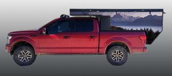

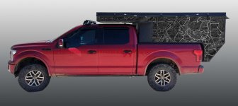

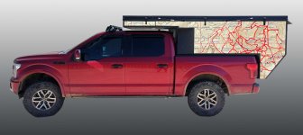

I love the ToPo map wraps. Adv. Medics, has all their rigs wrapped like that. And our business cards as well. Those rigs had a hard life, and the wraps had about a 5 year shelf life.
I'd go with the topo map. The bear with the gun is one of the most juvenile things
I've seen as a wrap! But, then, 12 to 16 year old boys might think it was really badazzzz.

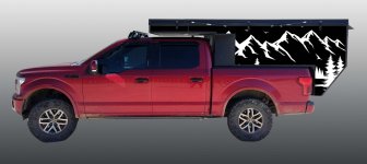

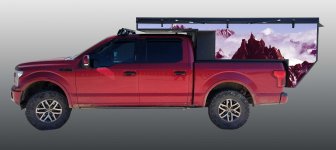

While I think most of those are cool, I know I would tire of the picture look. For the most part I want it to be subtle so I have requested changes and received them and these are what I am leaning towards.
This would be on the drivers side, as is.
I am leaning towards this one for the passenger side. I will ask him to make the white, less white so it matches the topo map color and isn't so bright. My wife thinks the sides should match. Not sure I agree. Anyone have any thoughts on that?
I am leaning towards this one on the back. I can't decide if I want to keep the bear or not. My wife states it should be a deer since I like to see them in the wild and I am taking this hunting. I offered I could put the deer in the bears mouth! I hope no redneck sees this and thinks a bear is coming out of the camper and shoots it. I am also a little concerned I will tire of the bear.
The bear with the rifle. Is there even a question?
For the side, I kinda like the map.
What about having it wrapped to match the truck?
Matching the red is almost impossible due to the paint actually being sprayed with two different colors. Also, I don't want too much red. I am thinking about a 1" red strip though. This small you may not notice the color difference.
Me too. The thicker lines are the trails we ride. Can't decide if I want to leave them on it.
As to carpet on ply, 3M clear glue does the trick and keeps auto/indoor-outdoor carpet on walls for years. I saw my old '84 Dodge van last week and the owner didn't change a thing, carpet is still up in good condition.
Very nice build, I think keeping it modular and removable inside is a good idea.
I agree on the juvenile comment in the long haul. Cool up front but not for long. I hope the three in the second post are much less juvenile.

If I woke up next to you camping and saw the Grizzly, my pants would be soiled. Love it for the back! I would wrap the sides with the same subdued tree pattern as the Grizzly back, and maybe add a deer on one side, and something else on the other. I really like how it blends with the black paint.
