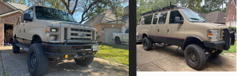

Meet the Storm Trooper. Just a minor modification but I wanted to paint the shrouds for a long time. The full glass headlights look a lot better, but these have to option to use DOT-approved LED sealed light and they are a huge improvement.
I used Duplicolor Ford Oxford White (In theory the original color) but it was too white. I tried Rustoleum blossom white and it seems to be a better match so both the grill and the lights are finished with this color.

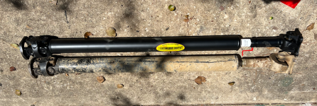

My drive shaft was too long and the ball between the two U-joints on the upper CV wore out, causing the vibrations. I ordered a new shaft from Tom Woods Driveshafts. Excellent service and I received it within a week. Here it shows the difference in length.

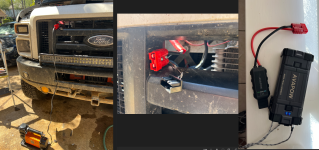

And an Anderson plug on the front grill for the compressor and the jump starter (I have a small electric loss that drains the battery if I do not run the van for a week). I replaced the alligator clamps on the Jump Starter and the Compressor with an Anderson connector so I do not even have to open the hood to connect them.

The new connector on the grill simplified tremendouslly the airing up process. No more opening the hood, climb to reach the battery. clamp the aligators...

I put those 175A Anderson connectors on several of my vehicles, and on my jumper cables. The connectors on the vehicles have gotten too corroded to function over a few years. They're great while they last, for sure.
