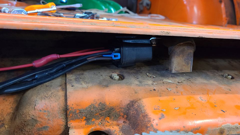

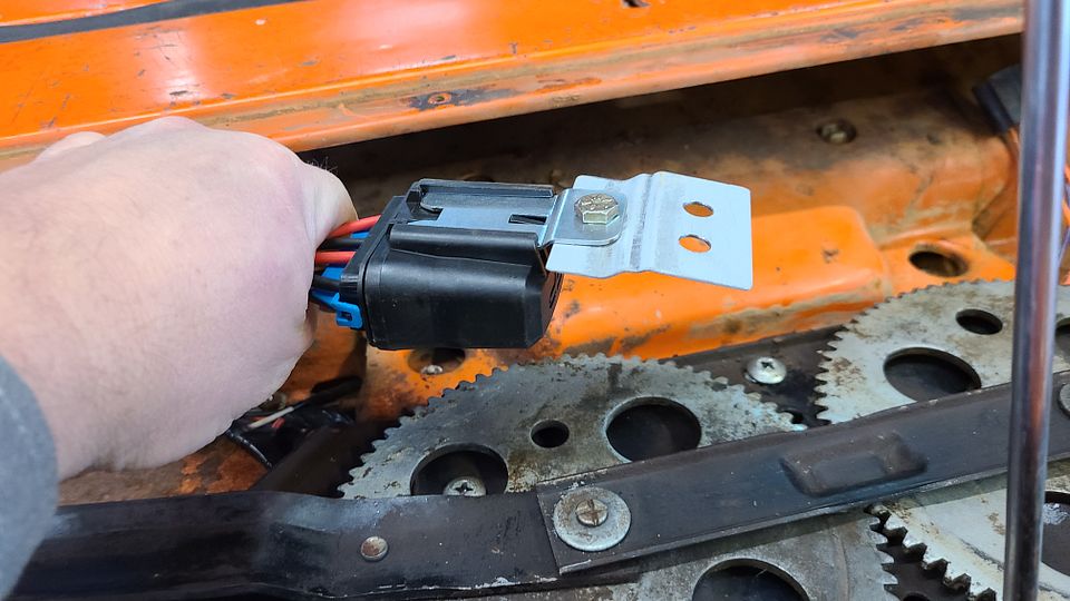

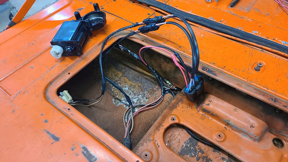

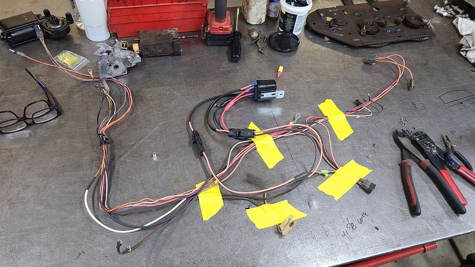

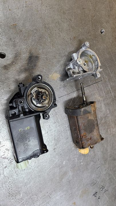

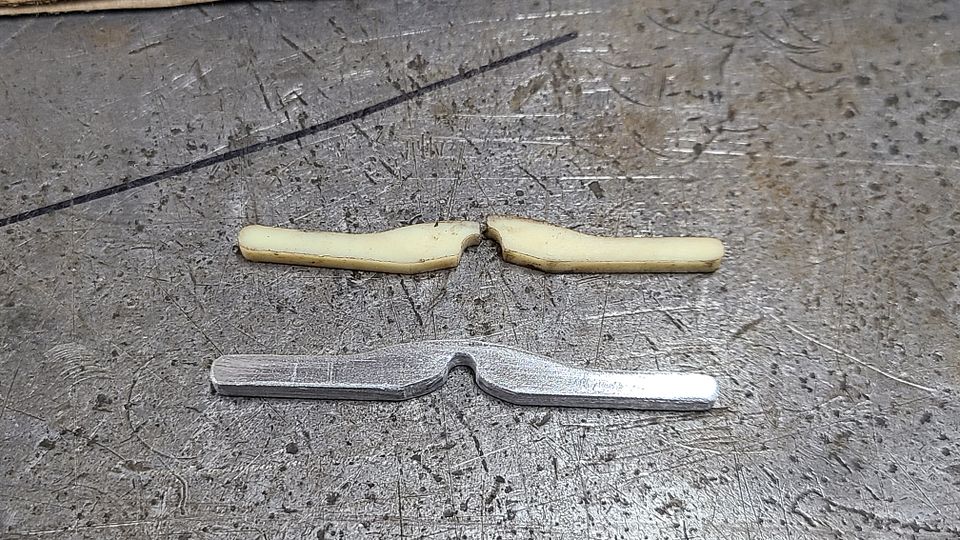

One of the items on the list was the rear window electric motor. It was actually rusted through and the window was stuck, luckily, in the down position. Finding a new motor proved to be difficult, as everyone that listed it was out of stock. Not deterred, I scoured the web for on that looked similar and found one from a classic Buick that looked the same. When I received it and opened the box, it was nearly identical except for two minor differences. Fisrt and most obvious was the body length, which was about half an inch shorter. Second and not immediately obvious was the length of the three legs that mount it to the window regulator assembly. My first thought was to use the motor portion of the new unit and attach it to the gear portion of the Jeep motor. I fiddled with this for hours and couldn't get the motor to work consistently, so I gave up. Then I tried rebuilding the rusted out Jeep motor, and I was able to get it to work, but again, consistency was the issue. Ultimately, what I ended up doing was to machine the three mounting legs on the Buick motor to make them shorter, and it worked like a charm. Sure, I lost the small register from each leg (which locates the motor in the regulator, but so far, this hasn't been a problem. One side benefit to using the shorter Buick motor was that the original motor was so long that the connector housing was contacting the body. The new motor, being shorter, allowed for a bit of wiggle room. And while I was in there, I installed a heavy duty relay kit from BJ's to help bring the motor up and down a little faster, and safer. I also rewired the entire tailgate. What a pain in the ass that was... The hole where the harness fits into the main body it super tight. It took a solid hour to get the wiring through the two holes and securely protected with wire loom.

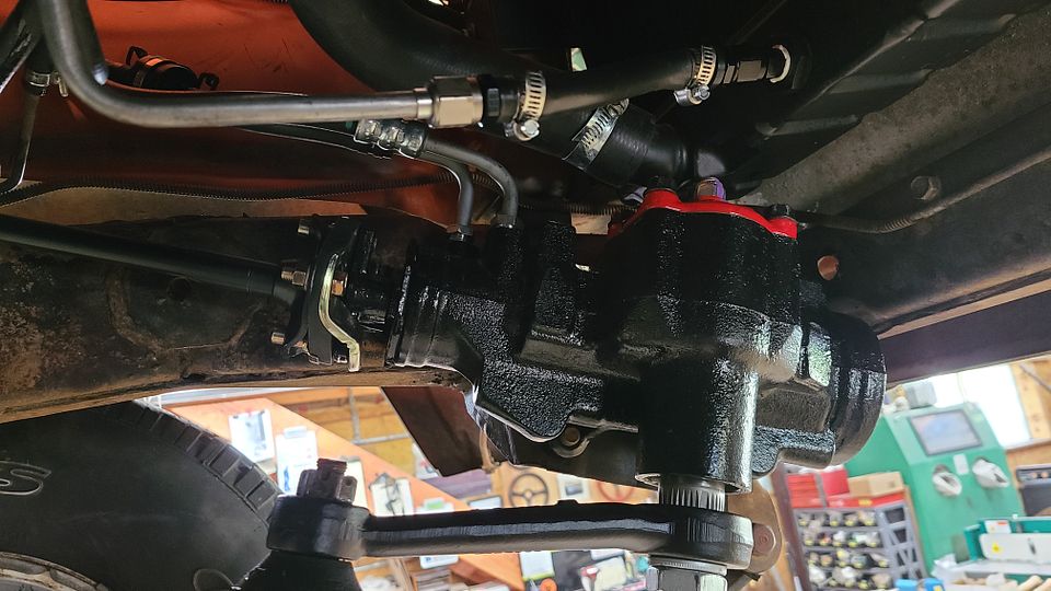

Another item that needed attention was the power steering. Even with the pump cleaned out and verified for flow, the box apparently gave up the ghost and would not accept the hydraulic fluid. Red Head Steering Gears is my go-to for steering box rebuilding, and I had a new one in a day. New hoses, new pump, new box. Everything there now works like it should. I even rebuild the shaft between the column and box and installed a new rag joint.

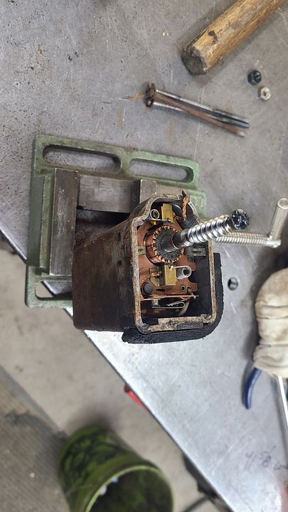

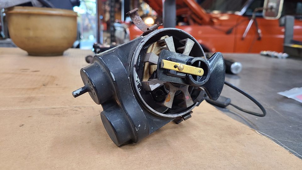

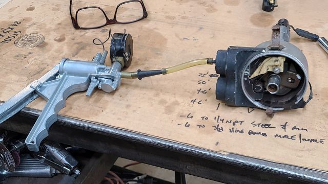

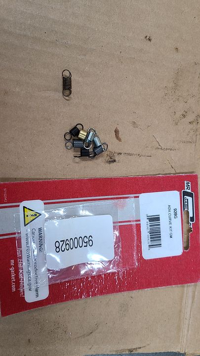

Driving around the neighborhood revealed an erratic ignition timing, which bounced around too much. I knew the distributor was not worth saving, but I wanted to at least give it a shot. I mentioned earlier that the distributor was "broken". Inside of the dual diaphragm vacuum advance module is a plastic double tree that connects the two diaphragms and acts as a lever against the moving distributor advance plate. The plastic tree was broken in two, and I made a new one out of .120" thick aluminum. That works like a charm, but the rest of the distributor was in bad shape. The mechanical advance was rusted, notchy and sloppy. Even after I welded up the shaft and the slots in the cam. So I ordered up some generic distributor advance springs and played around with it until I got the mechanical advance working properly. It still could use some work, but alas, I'm throwing in the towel and ordering up a new HEI unit from D.U.I. The reason I'm giving up on the original unit has nothing to do with the distributor itself. The reason is the cap. I've ordered three and all of them have been manufactured incorrectly with the eight contacts molded off-center inside the cap, allowing them to contact the rotor. My temporary solution was to grind away at three of the contacts until they cleared the rotor, but this is not perfect and even slight pressure on the side of the cap while the engine is running will allow the rotor to contact the cap. Attempts at rectifying this through the suppliers have come up dry. Not one to beat a dead horse, I'll change it out with a distributor that is proven to work.

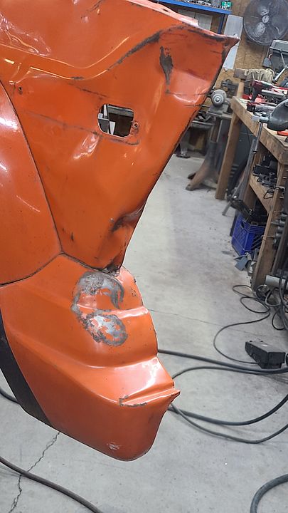

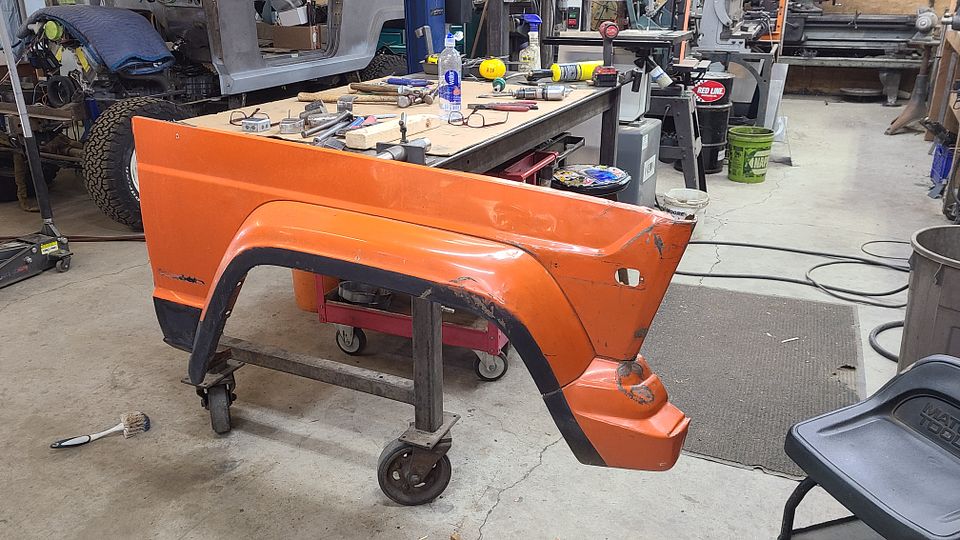

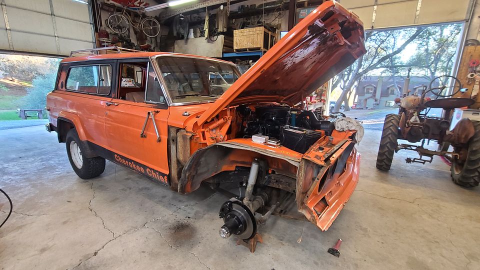

One non mechanical item that was bothering me was the left front fender. It had taken a small hit and I wanted to straighten it out as much as I could. I tried first to ********** it into shape while still attached to the body, but eventually removed the fender so I could get a hammer and dolly in all the right spots. It ain't perfect, but it looks and fits better now. Overall, the body is in pretty darn good shape, and I intend to leave it alone as much as I can. There are three small rust sections and luckily all of them are located inside the black portion of the body, which I plan on repainting anyway, so when I get around to those repairs, no orange paint will have to be disturbed.
Here's the fender.

I hope you can still find the parts you need. Even 25 years ago some parts were pretty tough to find. No surprises about the problems with the ignition system, and good choice going with the HEI. I see that auto parts store ignition parts are of equal lack of quality from 25 years ago. The joke then was that AMC should have made a 9 cylinder engine so that it would run on 8. I can't remember many FSJers that drove a lot keeping the stock ignition system. Most eventually got fed up and upgraded to something else.
Jeeps of this era definitely stood for Just Everyone Else's Parts. Luckily the Ford and GM parts are still readily available, but anything AMC specific will likely be difficult as it was already difficult 25 years ago.
Thanks for saving this Jeep. It brings back a lot of memories. The ones associated with tailgate window motors and wiring were memories I was hoping to forget permanently, but I had so much fun in my 70s Cherokees. They're such an ideal size with a lot of payload capacity. Not too big, not too small and loads of character.
Thank you for chiming in. You've just answered one of my "questions for the experts". So it's not just me that's had problems with this ignition system then.

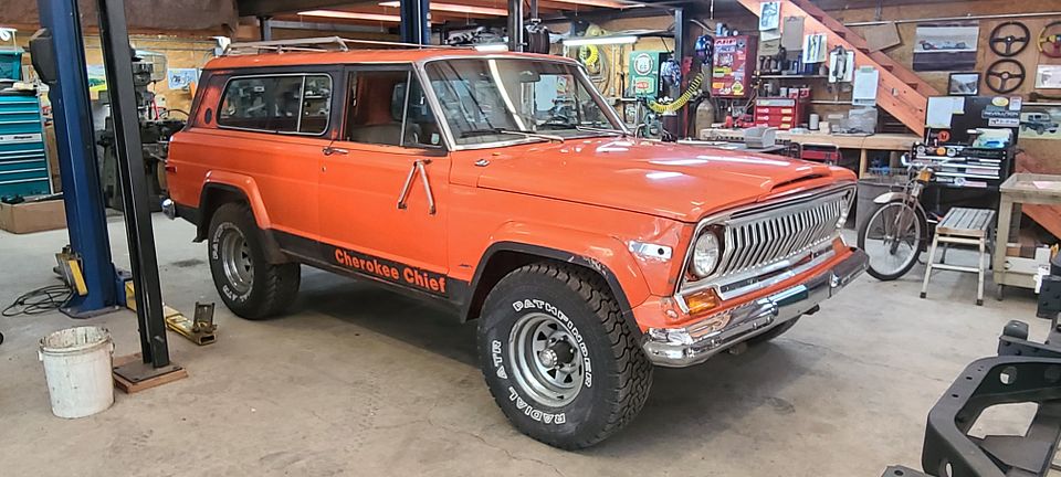

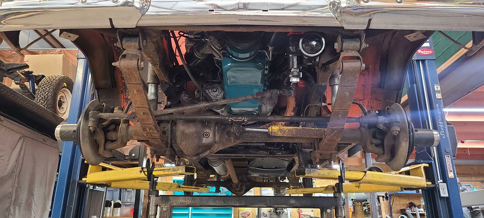

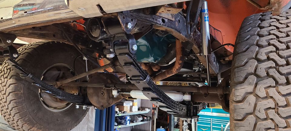

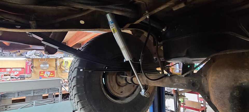

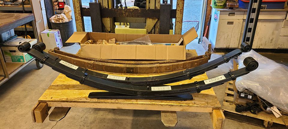

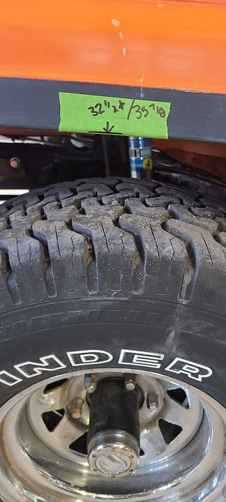

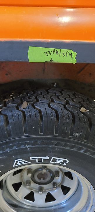

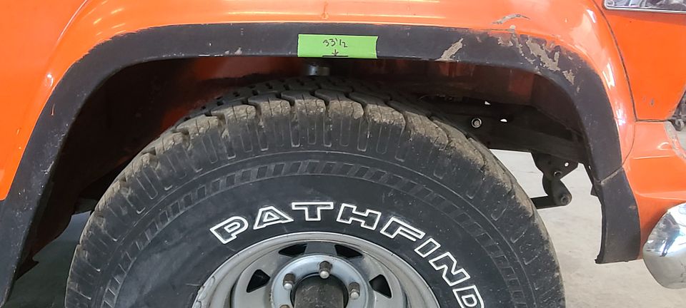

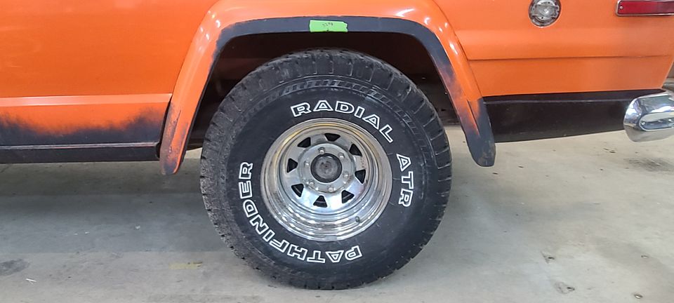

Speaking of gangster lean, my Cherokee had a lean, and it was pretty consistent, so I knew it was probably a bent leaf spring. Knowing that I wanted to use this Jeep in the snow, I settled on a 33" tire size, and I would have loved to keep the ride height stock, but the two factors - gangster lean and 33" tires - forced me to buy and install a lift kit.
I bought the 2"-3" kit from BJ's, which uses Deaver springs and Bilstein shocks. The springs have many more leaves than the stock springs, but this doesn't mean they ride too firmly. I am very happy with them. Overall, the kit was pretty well thought out, except for a couple issues. One was the front spring pins. The diameter was too large to fit in the spring perches. The second, was that the driver side pin was too short to engage the original steering stabilizer bracket, which sandwiches between the leaf spring and the axle housing. I removed them and installed a pair of socket head cap screws that I machined to fit. Other than those issues, the kit was pretty comprehensive. Note - why do shock manufacturers supply bushing sleeves that are much too short? I hate this. If you install them with the supplied sleeves, the bushings squich too much and are destroyed in a matter of months. Solution - machine my own sleeves. This allows the bolt/nut to tighten firmly against the sleeve without over-squishing the bushing.
Here are some pics, with before and after measurements.
Before -
After -
