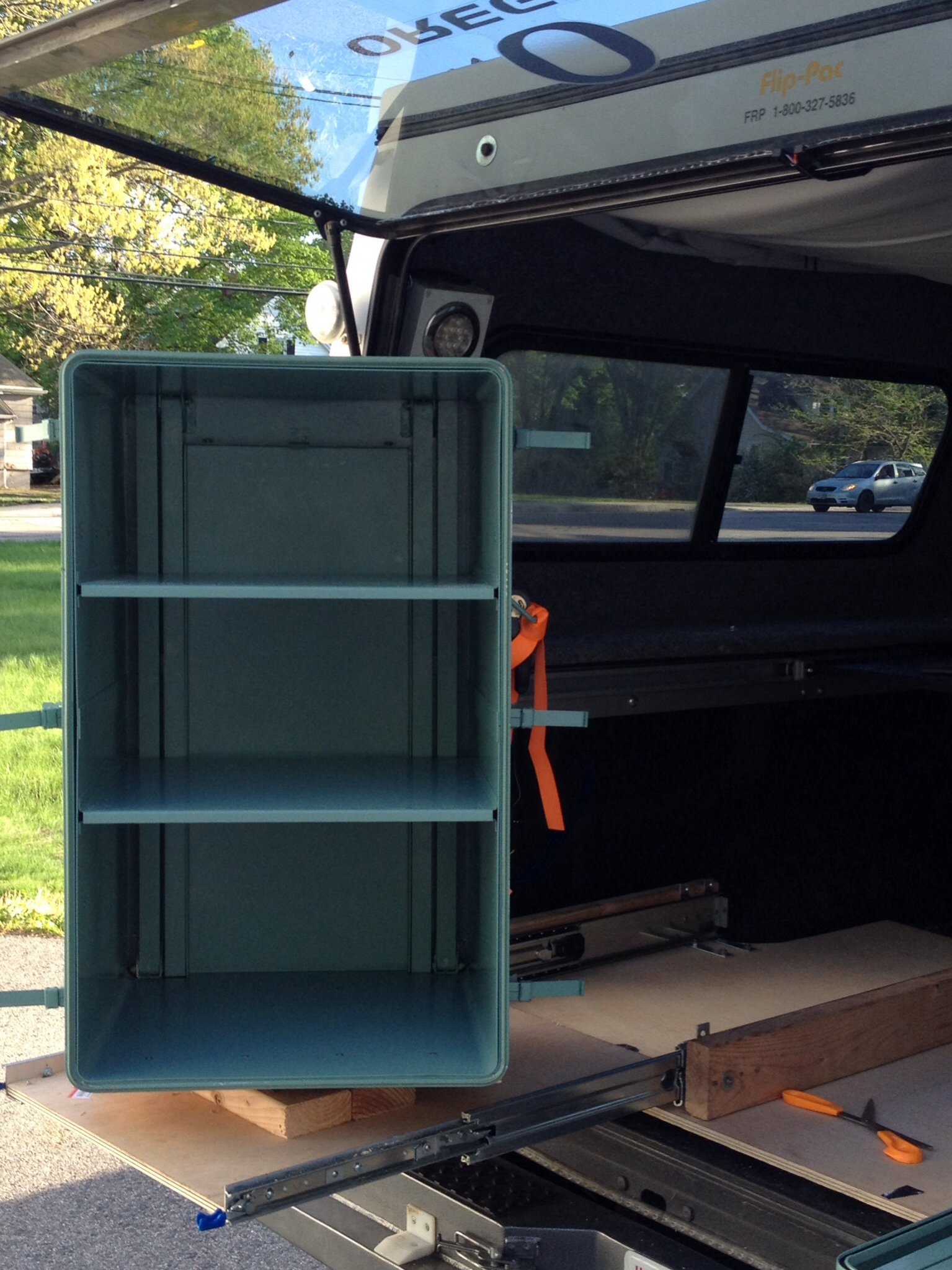

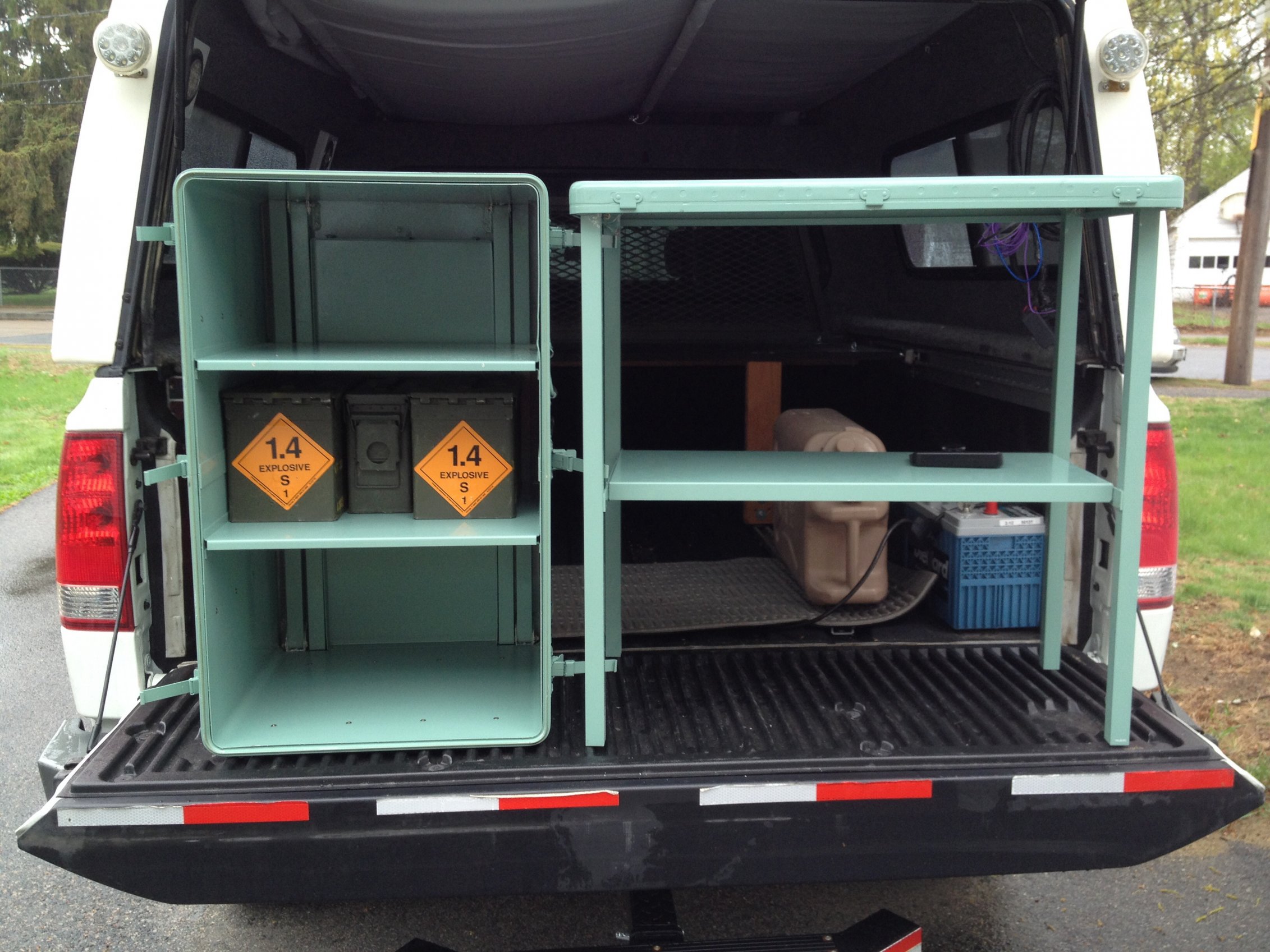

I use this medical chest (borrowed the idea from RoamingRobertsons). Which is pretty nifty I think as the front & rear pop off & can be used as 2 tables.
I put it on a drawer slide, then put a lazy suzanne on the drawer slide. Has worked great on the few trips I've made with it so far.
Yeah the one I use is heavy, but I could manage it by myself (before I did the draw setup). Now I just leave it in my truck most of the time. At camp it stays on the draw slide. Easy.
