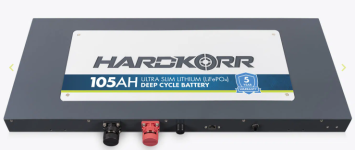

A few examples :
Sonny 12V 100AH (LifePO4) SUPER SLIM Deep Cycle Battery (B-LFP-12-100S) 23.5"x10.5"x2.5"
BEIAMP Super Slim 12V105Ah LiFePO4 19.5"x 9.75"x2.5"
Hardkorr 105Ah Lithium (LiFePO4) Slimline Deep Cycle Battery 28'x 13.5"x2.0"
