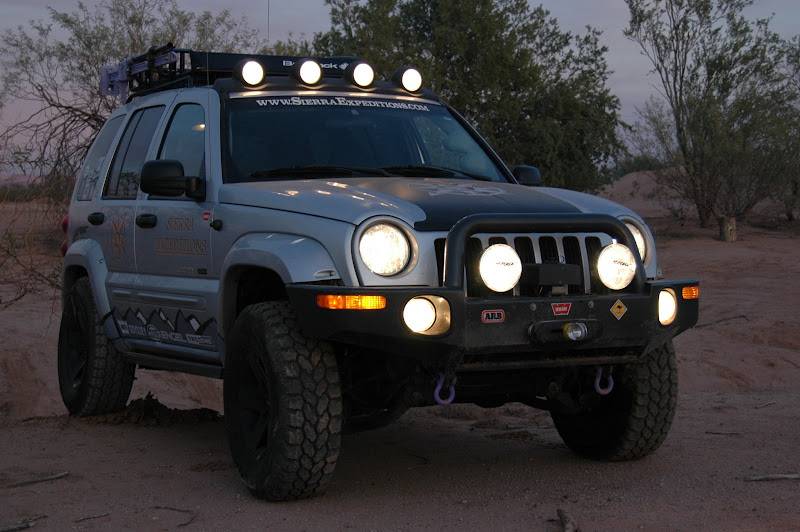

Well having a few sets of LightForce lights, I am very happy with them.
We have a set 170's with the 100w Verticle Filament bulbs on the KJ, and they are too bright to use on the road... I think that oncoming traffic would be really mad at us.
On the truck we have a set of 240's... again, too much light for on road use.
To the OP (duner) I would think that a set of 140's with a lower watt bulb like the GL04, would do the trick for on and off-road use.

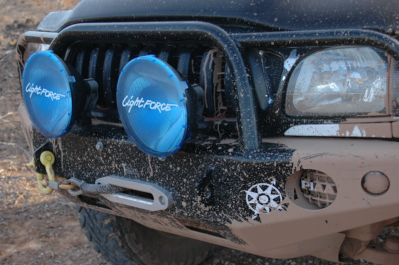

The crystal blue filters on the LF's produce a white(ish) color, not blue. It is a similar output to a 5000°k HID, and more a clear light between the clear filter and the crystal blue. Using the crystal blue filter on my LF's gives me a whiter light than my PIAA's (which I dislike).
Oh yeah, In that picture it was our first run with the crystal blue filters.
