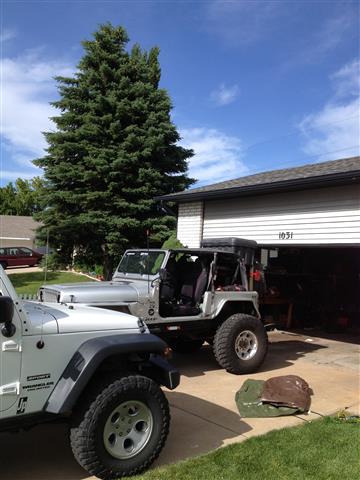

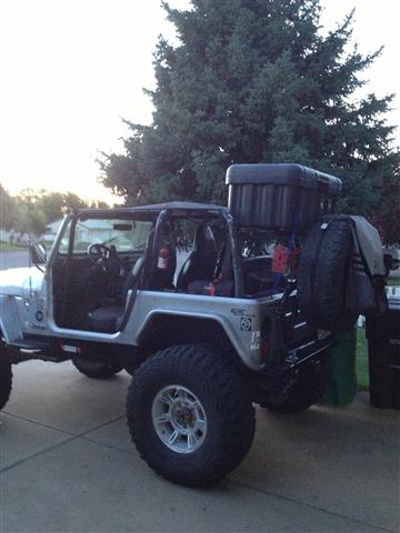

Any news from Aqualu on the tub yet? Just packed my Jeep for Rubicon later this week and am wishing I had stretched my YJ tub now. :D Love your ideas and subscribe to your same "build it strong" philosophy. (nevermind the daily driver JKU in the foreground :D)
The below will work for the trip, but it's top heavy and hard to see around.

How many people are you taking on the trip? I'm guessing since you have the rear seat in and open its 3 or 4?
Honestly I think most Jeeps, even long wheelbase versions are good vehicles for 1-3 people if they pack LIGHT. It's really tough to just take less and leave some space open. That is what needs to happen though for the most part.
Myself and two kids. We're downsizing for this trip (Rubicon) from a travel trailer. Tent, pads and bags are in the container. Tools/spares are already in the Jeep. Packing clothes, food and water in every place I can dream up.
Hoping to do hole-in-the-rock this fall. Another two night trip (likely have the JKU and two other people along for that trip)
Like you, I rarely use a spare, but am going far enough I think I should carry one. Leaving spare shafts, drive lines, and leaf springs on the trailer.
