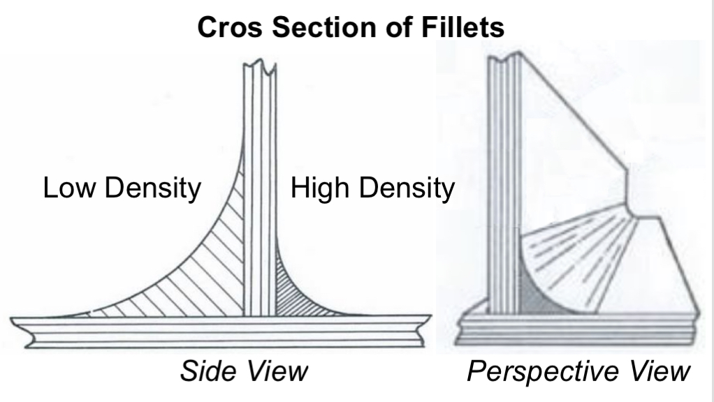

I like your method of construction. I am thinking about using 3/4 plywood on an teardrop sized camper. I would like to have large radius corners, in contrast to most boxy square corners on most homebuilt teardrops.
Do you think a router jig as shown in the drawing will help me achieve my dreams? Also shown in the drawing is an internal strip. 3/4 x 3/4. It will allow me to drive some screws prior to fiberglass. What do you think?
The yellow portion is wood?
Instead of being square, Id suggest you make it larger and a triangle, essentially as a large fillet/chamfer
It would be stronger, with less "waste"
Like so, but wood. Not thickened epoxy
Yes the yellow is wood. I was thinking screws from the inside. I was thinking square would be good because I could drive screw both 90 degree directions.
Thanks for the info on fillets. Seems like there are many crossovers between camper building and boatbuilding. I think most of us would be better to lean towards the marine style of building and not as much build like a house
