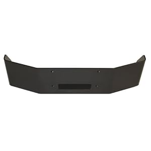

any chance you could sell a piece that is just the main plate from frame horn to frame horn so us DIY guys could make a tube bumper off a known base?
You could use our FF001
(shown raw, production is coated black)

x2. It'd be sweet if it included a winch mounting plate too.
Interesting to see the differing methodology of increasing bending resistance of those bumper bar/crossmembers/whatchamacallits. UJ uses shape (looks like its formed into a channel, no? I checked http://www.ujointoffroad.com/bumpersextras.html but it ain't there :( ) while MGM uses angles and gussets...MGM's looks like minimum bumper thickness is substantially increased while UJ's would be more universal.
It has 1" flanges that run on the top & bottom, hard to see in the pic. The FF001 is on the 4wd parts page.
