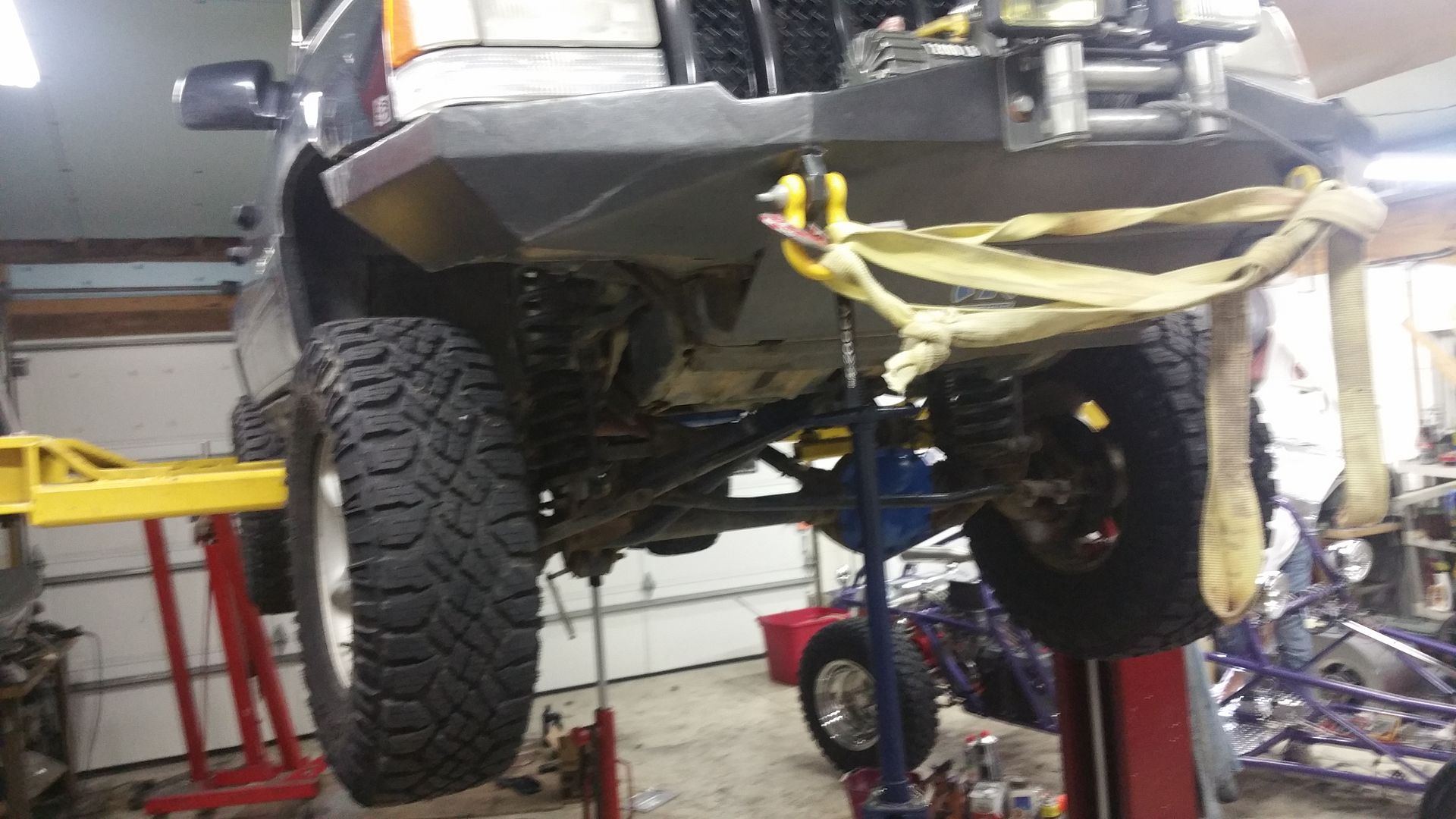

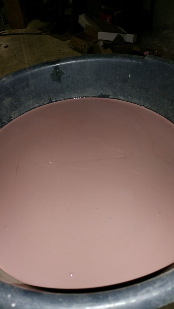

So...I may have missed relocating my breather tube on the transfer case...Axles have been relocated for awhile...
Also did motor mounts, pass side was soft, and going bad, drivers side bad begun to deteriorate, and was about to go bad...
Well, after thinking that the water in my t-case was the cause of unbearably loud "growling" when driving, it wasn't...it's had a noise since I bought it, but now it is getting louder...so, it looks like the noise is coming from none other than the D44A. It looks like the 8.8 swap is about to happen in the next month. Just have to finish up some inside the house winter projects before I get to work on the Jeep.
