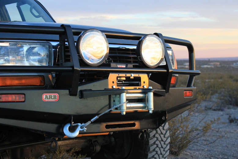

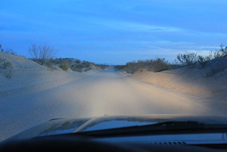

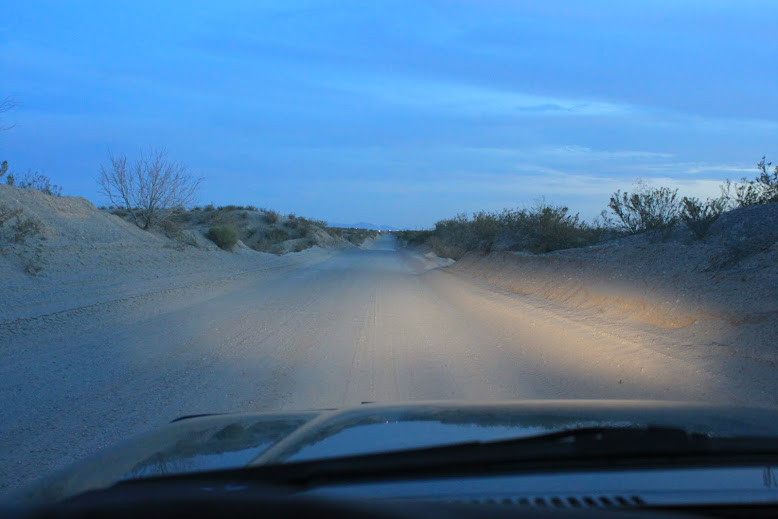

I have always been a sucker for a set of Rallye 4000s mounted to just about any thing, baja truck or a kitted out expo rig, there is some thing about that classic look. So when it came time to ad some aux lighting to the bull bar I was already sold, but I did some looking around and found that there may be some better lighting options out there, be it price or quality but I just couldn't resist. I already had the Slee upgraded headlight harness so the choice was natural to go with there aux harness also. My harness was installed by the previous owner at some point and did not have the plug in for the aux harness. A call was made to Slee to see if it would still all work out, turns out all I needed extra was a jumper from the headlight to the harness and there aux harness plugs right in. I set it up to operate off the high beams so that I could use them on back roads and kill both the highs and the aux lights at the same time if oncoming traffic was encountered. I also use the oem like switch they offer for a clean look. Sorry its not pitch back in the pics, but they get point across.
No lights
Low beams
High beams
High beams with Rallyes, plenty of light now!:sombrero:
