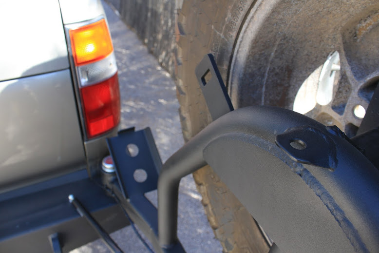

HD spindles were used on both swing outs. Struts keep the swing outs open even on a slope, nice option to have if you need to get in to the drawers on the trail.
HiLift mount and CB antenna mount on the tire swing out.
