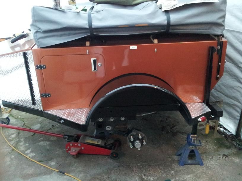

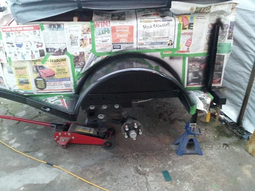

Suspension pic request. Do you have any side view pictures of the trailer with the new suspension before and after the lift? I am just wondering how much lower the new suspension is vs the original prings vs the final setup.
I did not take any shots of the height changes as i went thru the swaps. The original height of frame above ground was 17 inches on YJ springs SUA. Installed the Timbren it went to 15 inches to frame. Added the 3 inch block out and its at 18.5 frame to ground.
Took the trailer out and about today for the first time since change ..it handles very well tracks well and no bouncing at all.
