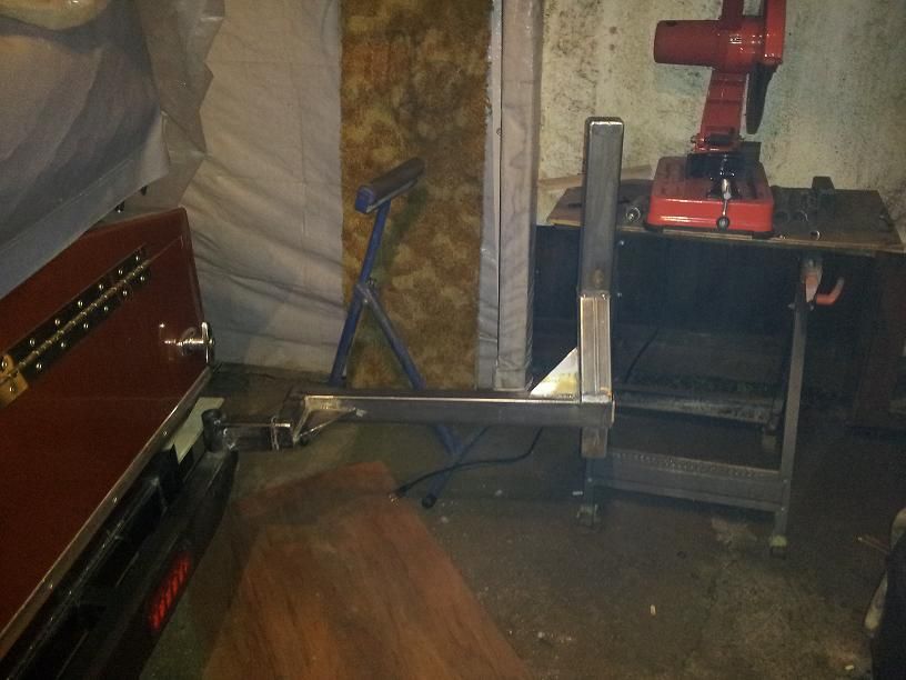

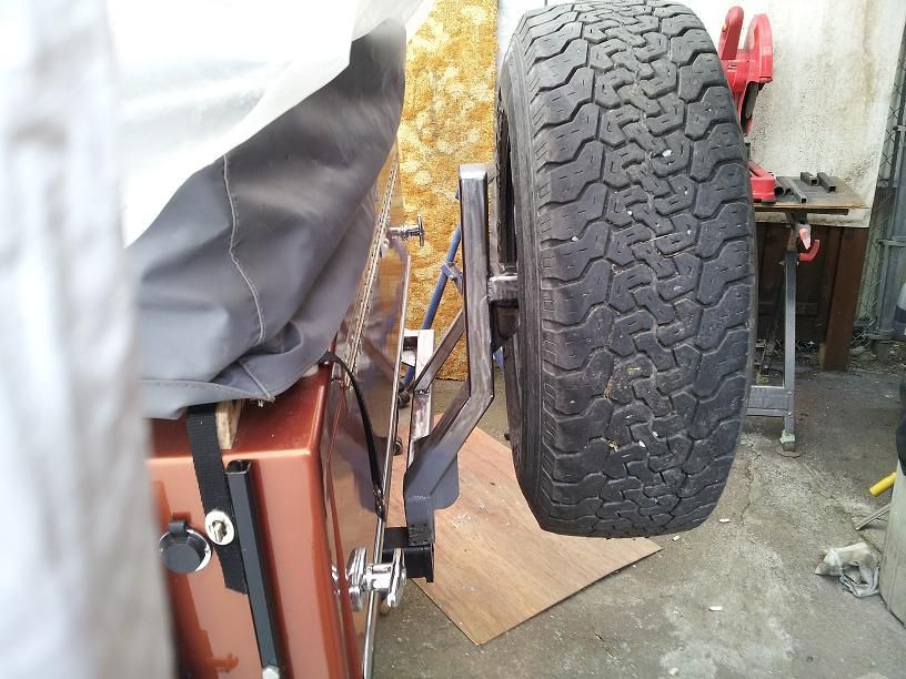

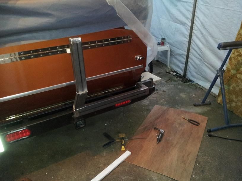

Decided i needed to carry a spare for the trailer. Worried on longer trips of not having a spare for each. Plus want to make some changes to my galley layout need a sink so back side of tire swing out will hold a double folding table and bracket for Hot water heater.

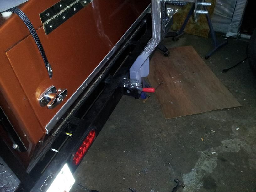

here's some shots of tire swing out so far.
It will lock into trailer receiver on back and be locked in with a pin.
Cheers
As usual, looks great. Were you planning to have it tie up the receiver? Since you are in the design stage, is there any thought to finding a different way to secure it so you could still use the receiver down the line? Maybe a gate latch type of hardware like the one in the below pic.
Your work always turns out amazing so I'm sure whatever you do will work well

Thanks for that TheThom, i guess i got one idea in my head and ran with it with out thinking down the road. Changed it now to use toggle lock. :)
Cheers.
Looks good! I'd recommend one more gusset on the upright. Once you have the weight of the spare on there, it will put added stress on your weld. Another gusset is easy and would sure it up pretty good.

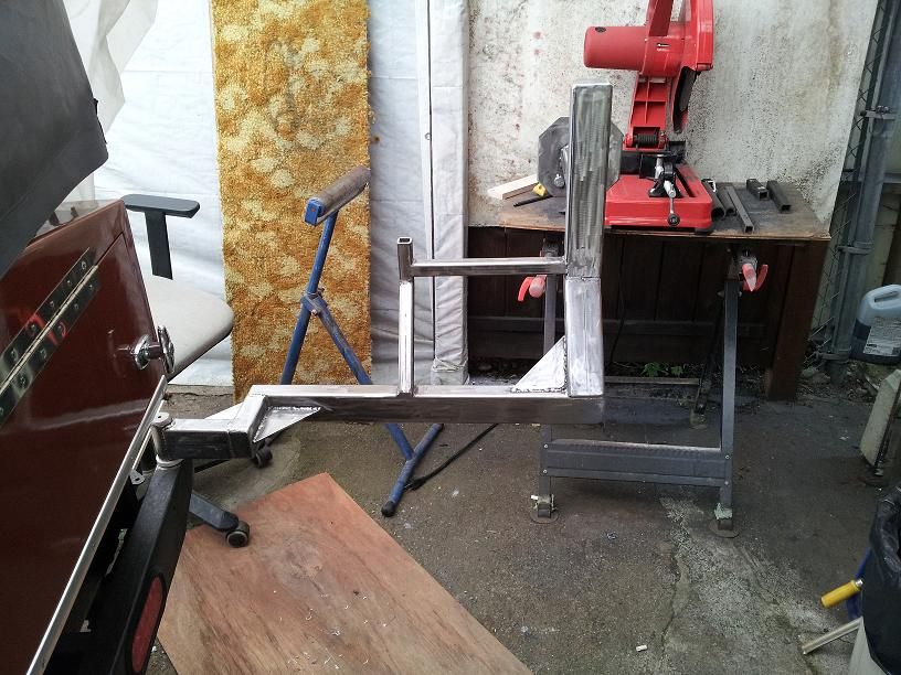

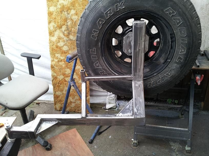

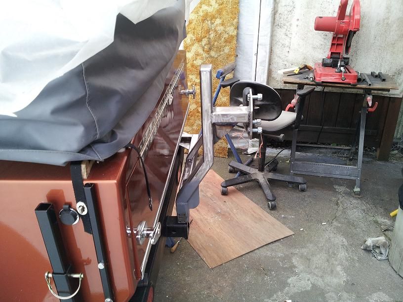

Well stage one of the change is more or less done. Have the swing out all fabbed now to add drop down table and mount to it for hot water heater.
gordinho80: i had planned on more gussets for the tire carrier just were not in pics, Thanks for the thought tho :) ..

Tongue weight changed a little from what i can notice just picking it up with tire mounted. Table and bracket on the back will only add maybe 5-10 pounds more so it should still be fine.
