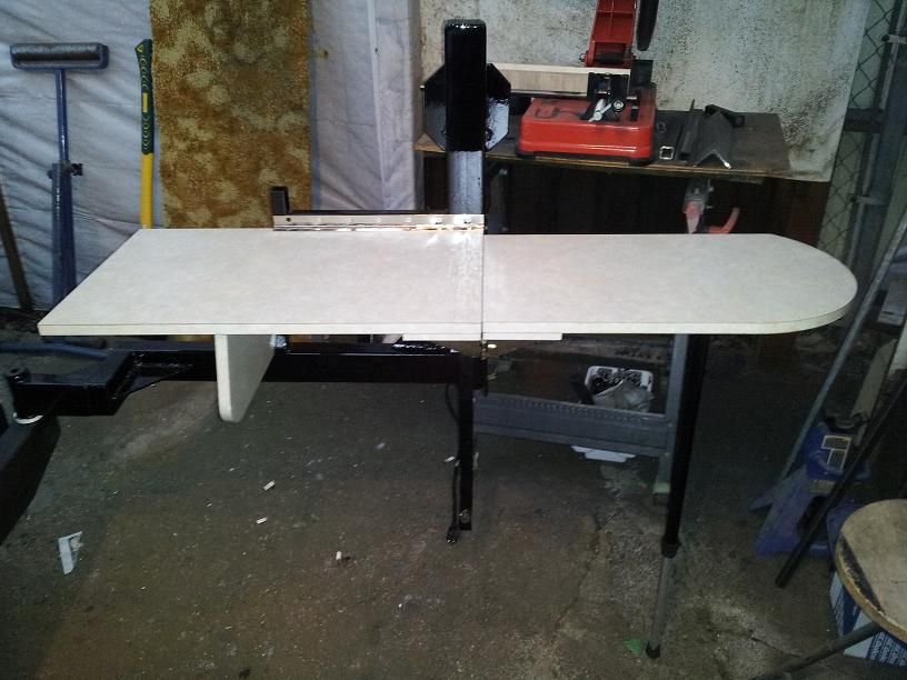

New table setup off swing out.

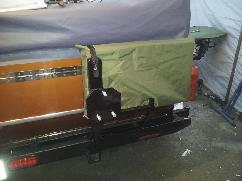

Closed and in bag for travel.

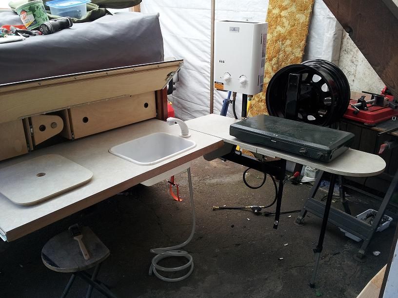

Now my stove can go on swing out table i added sink and tap to old main slide out. Both sink and tap are removable for travel, tap comes up thru table and fixes into a grommet i made to hold it.Sink is replaceable by drop in piece shown sitting on counter. Mounted my water heater to swing out frame.
Completed kitchen setup.

It looked great up close Mike, fantastic work for sure. I really like the way the swing out and the existing re-worked counter are the same height and the sink is well, just a bonus. This setup is great man, cant wait to get out for another trip soon!
Do you keep the water heater outside permanently, or just hang it up as needed? I'm going to go with a portable setup for now (Zodi) but I think I want to go with a more permanent solution down the road once I have my water plumbed in on the trailer (not to mention my battery/electrical).

Once again, very nice work. Only question is do you have an awning/cover for the kitchen area incase of rain?
Ah, make that 2 questions. :D What brand is your water heater? We don't get them down here in Aus but thinking of ordering one in.
