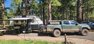

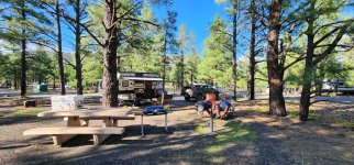

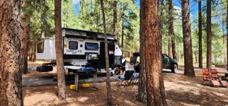

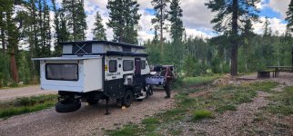

Took our 2 week road trip around Arizona territories. 2k miles total, 1 blown tire on the way home, small price to pay for all the great times and memories.
Demotte campground:
North Rim Grand Canyon campground:
Pine Grove campground:
Bonito campground:
Demotte campground:
Bonito campground:
