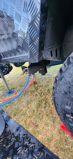

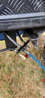

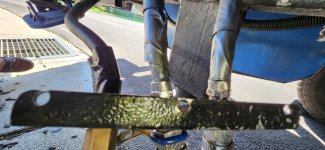

Did anyone else lose the 2 external water lines and quick disconnect gas line on the passenger side when the tire blew? Just got done replacing mine after the blow out.
Yes, it was a bit of a mess. My Triangle branded tire blew out on the way to a camping trip in Big Sur California. I had to make temporary repairs at the campsite.

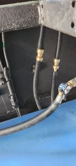

Where did you find those 12mm to 1/2 inch splice couplers? I couldn't find that 12mm white hot water line anywhere.
I purchased half inch outer diameter PEX white pipe from Lowe's along with shark bite couplers. I basically made it work.
You can also find some of the parts you need at Opus camper parts purple line.
Purpleline has couplers and replacement piping that would work.
SharkBite 1/2-in x 5-ft White PEX-B Pipe Lowes Item #818182
SharkBite 3/8-in (1/2-in OD) Push-to-Connect Coupling. Lowes item number 818053

Tire blow out the other day. Kinda hosed myself by not having a proper jack ( lesson learned). I waited 4 hours for aaa. Went to harbor freight to pick up a floor jack. Checked the pressures b4 I left, everything was ok. Thankfully minimum damage to wheel well.
This happened on highway driving 60 mph with the triangle tires.
