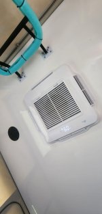

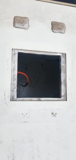

I've shipped out 5 adapters. I plan to ship out 3 more this afternoon. I'm also placing another order for more kits this week.
$350
What it does: deletes original over the bed skylight that acts as a furnace in the summer and creates a standard North American RV A/C opening. Can also be used for a Maxx Air Fan.
What's included?
    • A/C adapter
    • Alignment bushing
    • Install assist tabs
    • Riv Nuts
    • Bolts/Washers
    • Instructions
What's not included?
    • Wiring
    • Labor
    • A/C unit
    • Common sense
    • Shipping
    • Tools
This will only fit 450mm x 400mm skylight models. If you have something other than this, DM me.
