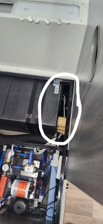

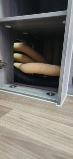

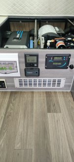

With the hot summer months quickly approaching us I know many folks are trying to find ways to improve the air conditioning on the dweller. Specifically I'm looking at the dweller 15 and feel there needs to be an improved system to recirculate the cold air. The current air intake found on the end of the AC unit itself is underneath the bed. The recirculating air intake should be set up so that the air comes 100% from the passenger compartment of the dweller not from under the bed. This way the air-conditioning unit continues to recycle cold air making it colder each time it goes through the system. Just like the air conditioner in your house. The grill on the control panel wall is too far away from the air-conditioning unit intake and very inefficient. The AC unit is drawing air from under the bed not from the Passenger compartment. Here are a few pictures of the air intake. For the dweller 15 opening the lower cabinet door on the driver side would actually improve the air intake. I'd like to hear other people's thoughts and any ideas of a better way to improve the return air into the air-conditioning unit. I'm not sure how the dweller 13 is configured. Thanks
