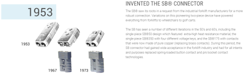

Sigh..... Because I know you'll make a smart remark about history class if I try to set the record straight, let me just go ahead and get in front of it. ;)
Have a seat over there, and turn your history books to page 1,877 and page 1,953. Here we can see Anderson Power was founded in the United States. Additionally, we can see the traditional "Anderson SB Plug" has been around for a very long time, originally used in.... forklifts. Australians (correctly) identified it as a better way to handle DC power loads with safe disconnect abilities. This falls squarely in line with how much more advanced they are, as far as anything and everything related to tow behind campers. Can you imagine if we had 12v cigarette sockets on our bumpers? :ROFLMAO:
@Suns_PSD check it out.
I changed my PP75 connector over to an SB50. I like them much better. I use mine for a portable 400 watt solar panel. I will eventually add a DC-DC charger on the truck side that will connect through the SB50 connector as well.
I agree. SB is better than Power Pole. At least for this application.
