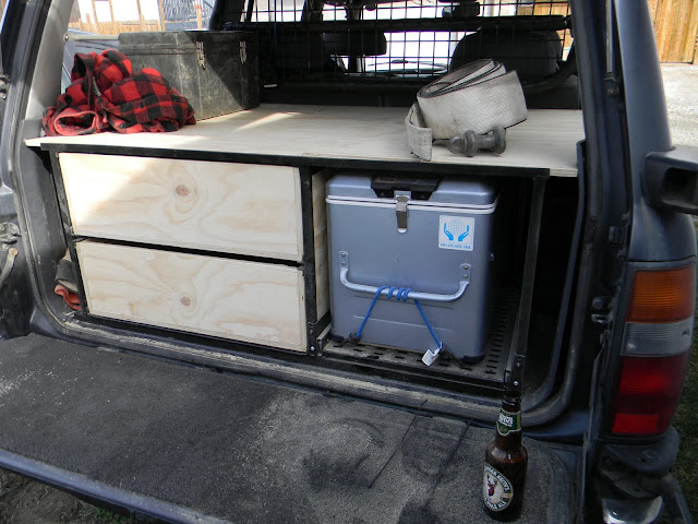

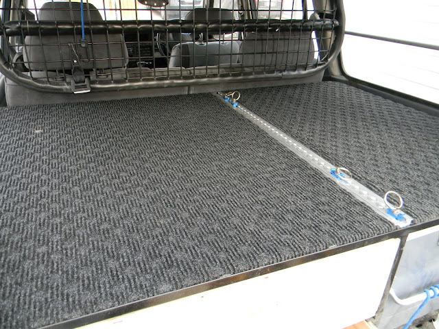

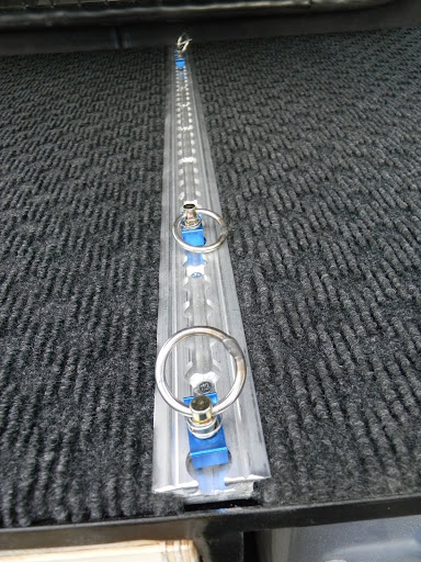

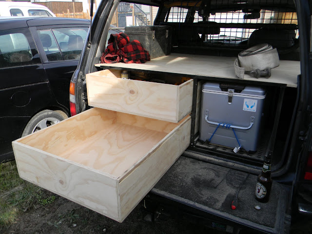

I built the drawers and added one of those tie down rails to the top. Will probably run across the back as well. I'm going to use the system-is for a while and will work out a any bugs when I add the aux battery and water tank in the spring.
