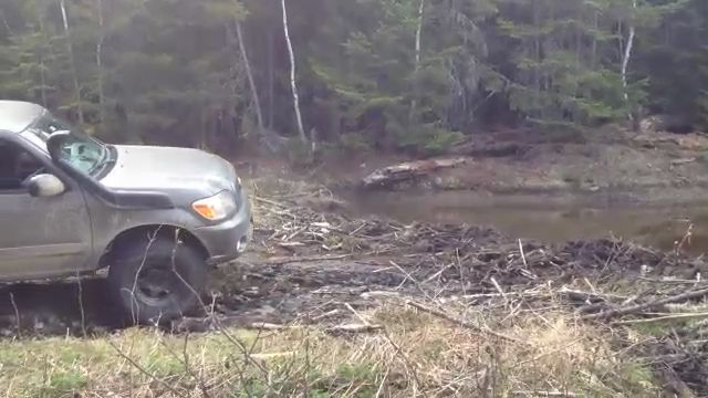

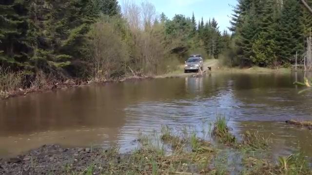

Bonus material: water crossings from our last trip!
How else are you supposed to check road conditions?
