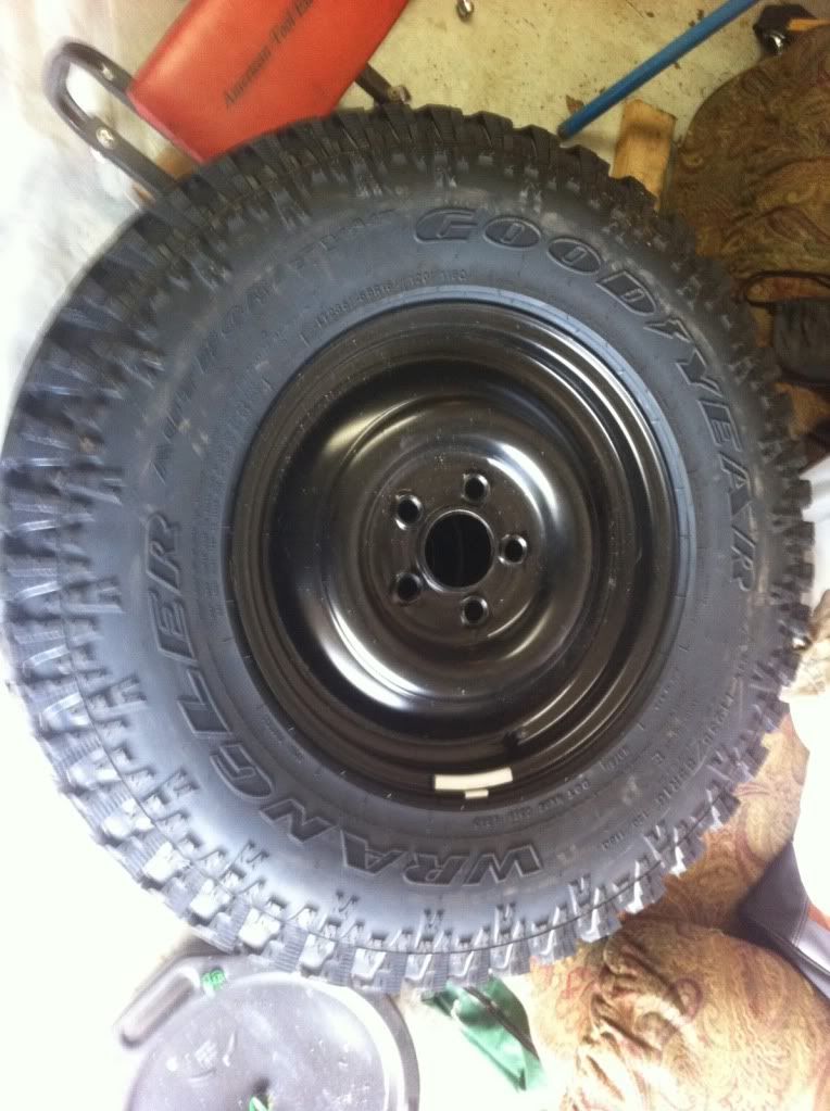

Getting rid of the 255 55r 18 tires and going to 235 85r 16's. There is a much greater selection for 16" wheels and the tires are quite a bit cheaper. I didn't trust the stock tires in the rocks. For myself, the 235's are the perfect size for my truck. I got the Goodyear Wrangler Authority tires and so far they have been great in everything I've tried them on. I went with steel wheels just because I made a great trade for them. If the factory alloys were 16's, I'd have probably stayed with them.
