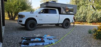

Someone off the FB group recently stopped at our place so we could jack up his camper and adjust bed mat.
He let me post this image on FB so imagine he'd be OK with here as well.
Gray camper on white truck is very nice looking.
