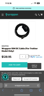

Speaking of, does anyone here have the Wrappon toilet? We’re out this weekend and got it out to setup for using it later (fortunately nothing urgent needed yet) and I’m sort of baffled by it. From the manufacturer it comes with a standard 2 prong outlet plug. However, SuperTramp have modified the power cable to have a solar panel plug instead.
I have no idea where we’re meant to plug this in. I do have the external solar panel port outside, but that should be for input not output. I tried plugging it in there just to see, and it does not power on as I expected. Additionally, the cable is too short to reach there, I had to build a makeshift platform to put it on to test this out.
I messaged their tech support but I’m not sure when I’ll hear back.

I have the Wrappon and absolutely love it it. Are you trying to use the toilet outside of the camper? I recently just purchased the 12 volt plug from Wrappon to be able to use in our outside shower awning with it plugged into the small anker power station that we have.

From what Kelsey told me yesterday, there should be a waterproof 12v plug in the shower basin. You should be able to use the Wrappon without removing it from there.
@ruadhrigh thank you so much, you’re right we totally overlooked that tucked in on the side in the shower basin! Our recollection was they told us it wasn’t really intended to be used inside, they must have meant the actual shower basin itself not the camper.
And yes @Brown229 we really wanted to use it outside in the shower stall, so I’ll have to see about getting a separate power cable for that like you did.
Awesome, we’re all set.

In the pictures below it shows how the Wrappon is plurged in while in use for inside the camper and then I highlighted the plug that gets unplugged to use with the Wrappon 12 volt plug and the power station we are using

So I have a Wrappon, I’m pretty sure mine was the first one ever in a ST because they gave me a TON of measurements before I committed to ordering the new version (I had a Wrappon Green and it definitely doesn’t fit). I ordered mine with the standard 12V adaptor and roll it up and place it beside the toilet. If/when you need to use it just pick up the coiled wire plug it into the 12V outlet and do your thing. I’m not sure this is something that need to be wired in by ST. And yes you can use it in place we don’t remove ours unless we are using the indoor shower.
