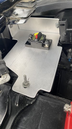

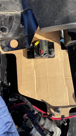

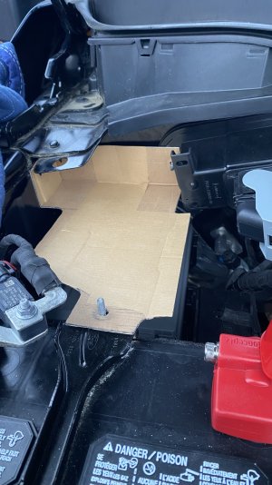

Tinkering and templating with some cardboard and aluminum to come up with a better place to mount the circuit breaker in the Super Duty’s engine bay. I could not find a product available that I liked so the need to create kicked in.
Camper pickup is in two weeks. No holes were drilled in the truck. I used three OEM attachment points and some 1/8” aluminum from past projects.
Trying to create some added surface area for future electrical expansion also.
Hope this helps others who are looking for similar solutions.
Looks pro! To protect any conductors that may come in contact with the outer perimeter and chafe, one could add some rubber, U-channel automotive edge trim along the edge along with some wraps of silicon tape on the cables themselves.

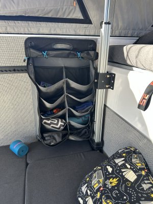

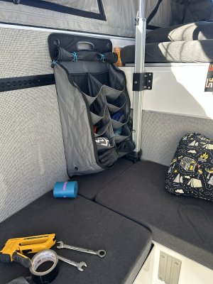

Inspired by the @Chadx spice rack I installed a Thule Shoe Bag on the driver's side of my STC.
We had the same bag in our van years ago and they are really easy to work with. Found one on sale for ~$40 so I figured I'd give it a try. They don't have any built in rigidity so I bought some composite plywood and stapled the shoe bag to it. Drilled two holes in the board (but not through the fabric) so I could attach to the l-track. Just did a week long trip to test it out and happy with the results. Easy access to random camp kit without being too bulky or intrusive.

Great mod! Compartment size and shape looks very useful.
Having the new driver's side interior L-track, especially with no artic tern windows down, sure gives a lot of mounting options along that wall.
Good point. That’s why I rounded and polished the edges to eliminate that being an issue.
