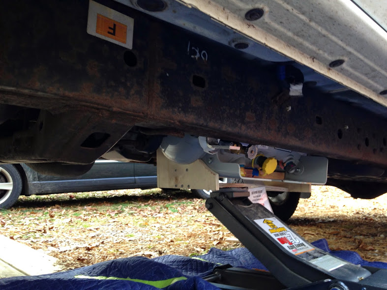

here is where I wedged the LP, the plywood is only to stabilize the tank while I had it jacked up in place and fabing the front and rear brackets
