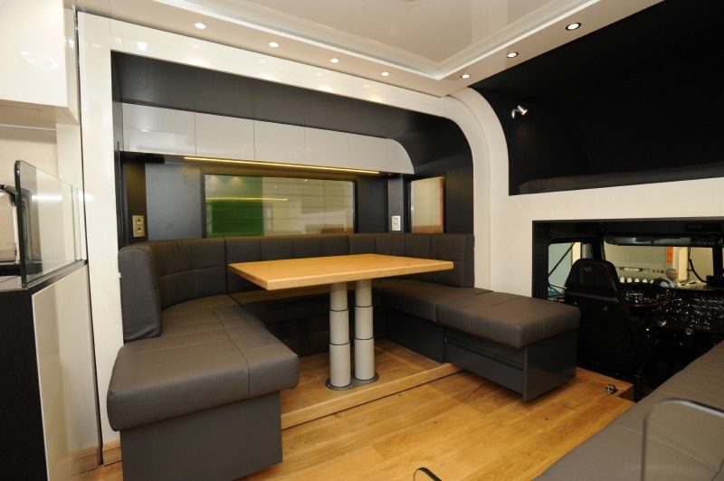

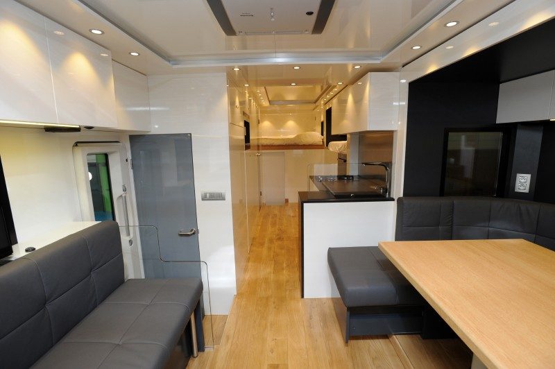

2. Ketterer Horseboxes
I am a real fan of Horseboxes, because even though they are often very big trucks, the fact that they have to devote half their space to carrying horses, means that the are forced to come up with creative solutions for the part of the motorhome occupied by humans. They are forced to try to “integrate” the cab area with the rest of the motorhome as much as possible. Some Horseboxes are designed to carry as many as 6 horses + 6 humans.
I have already posted some images of how Ketterer tries to accomplish this – see post #110 at http://www.expeditionportal.com/for...pedition-RV-w-Rigid-Torsion-Free-Frame/page11 . Ketterer is/was considered Germany's premium builder of Horseboxes, but its website no longer seems to be working, so I wonder if it has gone under? See http://www.ketterer-trucks.de . Glad that I downloaded most of the website when it was still working!
Here are the images of some Ketterer interiors that I posted earlier, plus some more that I have not yet posted; images that, it seems, are no longer available online…..:(
CONTINUED IN NEXT POST
CONTINUED FROM PREVIOUS POST
In all of these images the seats immediately adjacent the living area swivel around fully to become part of the living area. And their backs fold down completely, to allow a pull-down bed ample room. So none of the cab area space is wasted.
