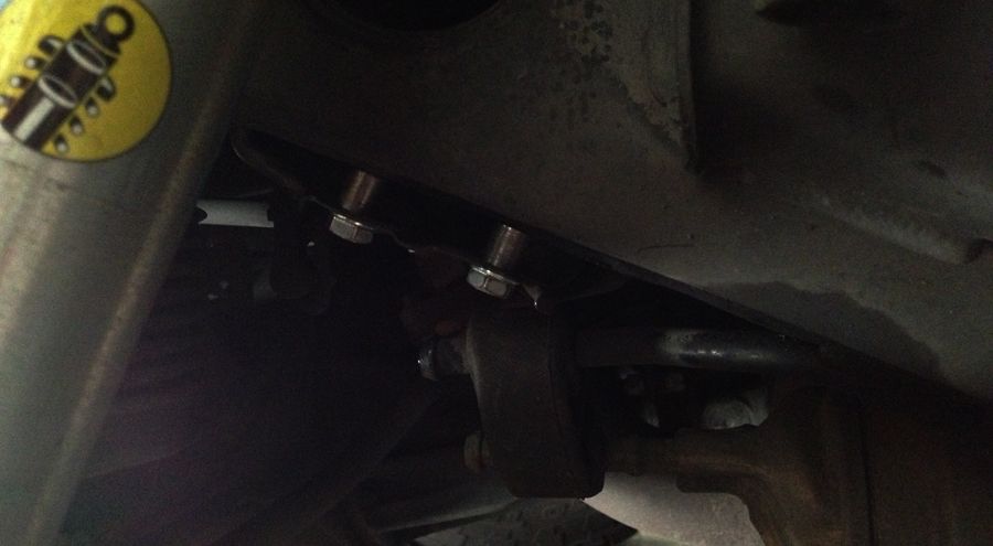

Bundu I am planning to lift my Gx but don't really understand about spacers to keep the rear airbags level with front that was raised? Would you have pics or better explain to me on doing this properly. thank you
TexGX

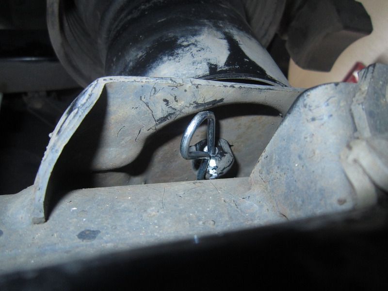

I used a half inch nut between the levelers and the frame. Check my build tread with for better pictures. I can tell you this is not a good fix if you plan on off-roading. Both Rou and I popped the air bags off and both switched to coils. The only thing that might work is pinning them so they don't pop off.
You add washers, nuts, spacers etc. between the ride height sensor brackets and the frame to trick the rear sensors to lift the rear.
*This is on the drivers side*

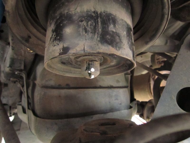

When TexGX says pinning he means to drill a hole through the airbag pin and add an "R" clip:
